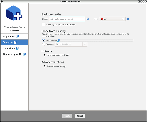

Specifically, in v4.1, I used to create a template for each app qube. I thought this was the recommended way to use templates back then. This doesn’t work in v4.2, because I can’t select a template when creating a template qube. I understand this is where that change happened.
I don’t understand why that change happened and what the recommendation is now. Is the recommendation to use a small number of template qubes and install necessary software in the app qubes?

To your second question as I know the command to create a new template from another one switched from qvm-create to qvm-clone. So of course it’s still possiblem to set up a new template based on an existing one. Inside the GUI the naming switched to clone, too.

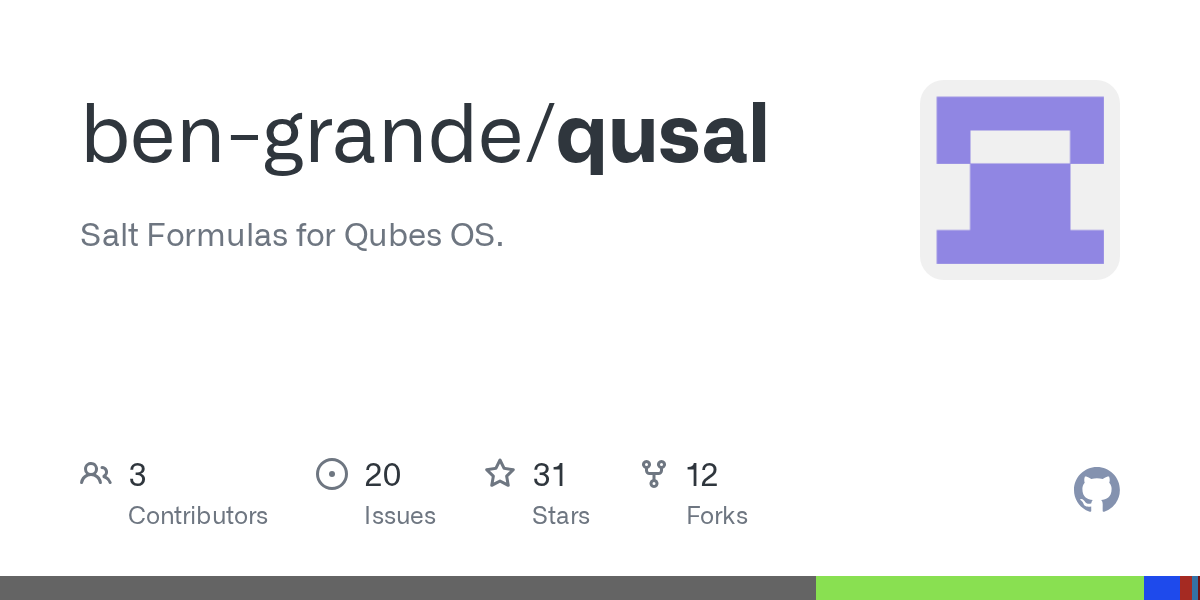

There is also a collection of salt formulas that are used to create qubes with specific function using minimal templates:
