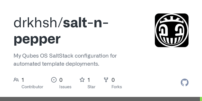

Tell me how to use salt-n-pepper
Hi, could you tell me how to use this?
I’ve tried various commands, but it still doesn’t work and it’s taking too long, so I asked this question
Is it correct to git clone to /srv/user_salt?
I’ve already copied it to dom0 but I don’t know how to use it
