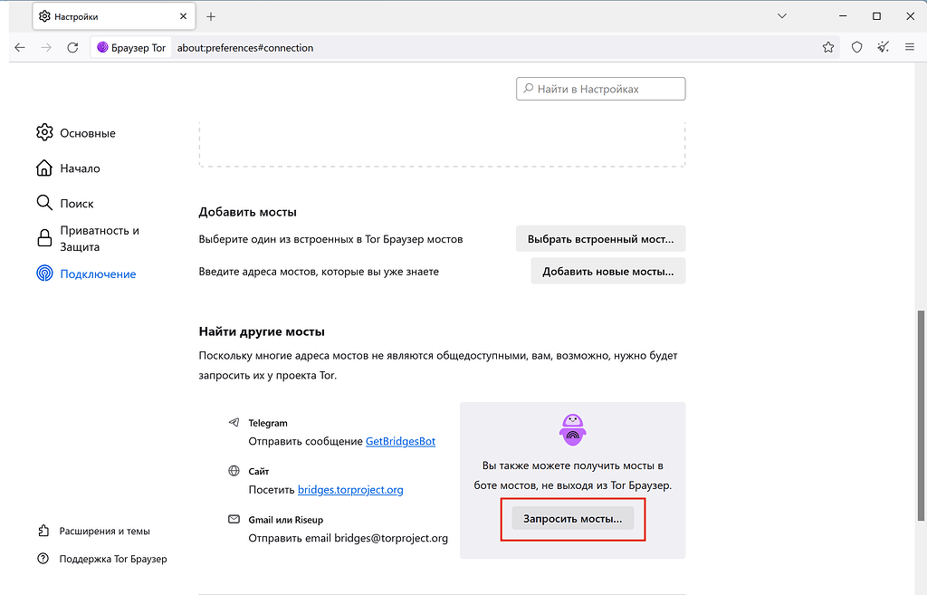

After that, I attempted to connect sys-whonix to Tor using Snowflake bridges.

I started by trying the free servers from this GitHub repository, then moved on to a paid subscription for Quattro VPN. The situation is the same in both cases: many servers respond to pings during the whitelist phase. Karing connects to them, yet sys-whonix still fails to connect to Tor. I’ve tried every bridge option as well as direct connections (without bridges). I’ve tested a multitude of servers that respond to pings, but to no avail.
