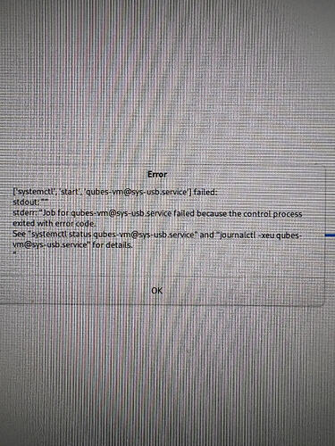

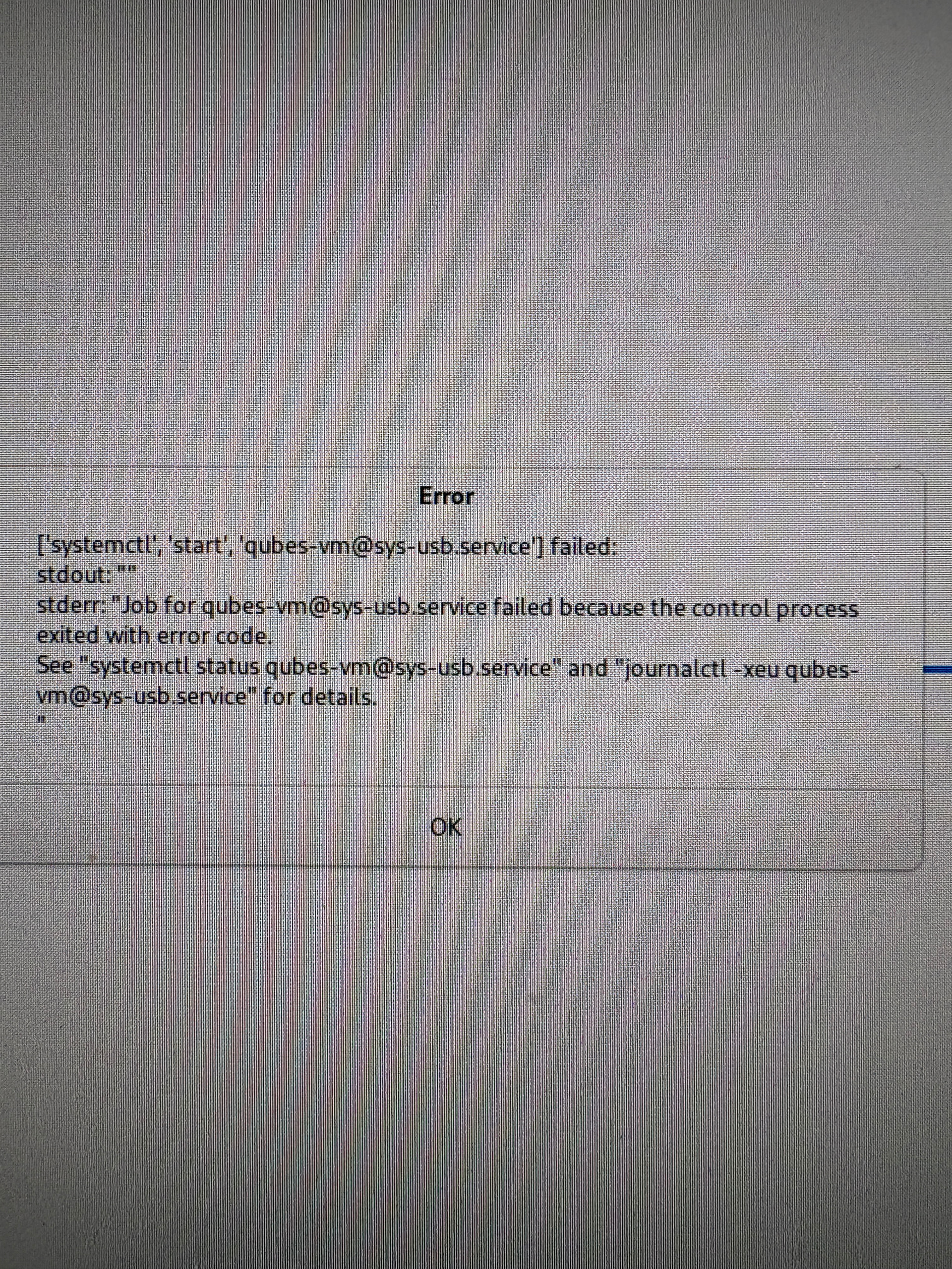

At the end of the install scripts / as soon as sys-usb is activated, it crashes (image). I had a similar problem after updating to 6.18 and later versions of the kernel. Locking sys-usb to 6.12 fixed the issue. Now, after the reinstall, I don’t have that kernel version.
Can you finish installing Qubes?
Ah, I see your other topic now.
I would reinstall Qubes, but this time I would detach all unnecessary USB devices from the computer and would uncheck the option to create sys-usb. After successfully installing Qubes, I would manually create sys-usb for each USB controller and start them one by one so I could know which one causes panic and what devices belong to it.
Also,I would not attach any additional monitor when installing Qubes. When having NVIDIA dGPU I would want to be sure Optimus mode in BIOS is selected (or similar wording, meaning both iGPU and dGPU are available for use)
