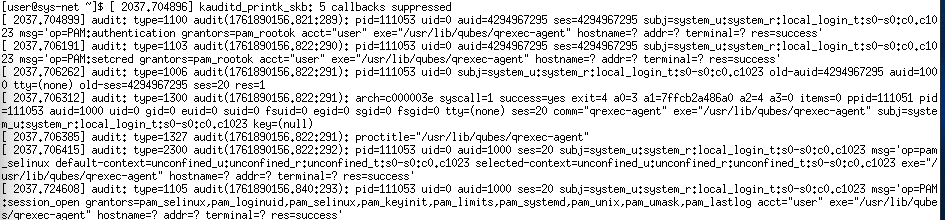

Attached below is the screenshot of the console output from qvm-running at sys-net. I tried reading it, but gleaned no useful information and possibly lost brain cells in the process.
hit ENTER in taht console and you will have chance to login user in it.
Then it’s almost normal terminal.
You could also open dom0 terminal and run journalctl -b -f to check live what’s going on when you try to run normal sys-net terminal.
Or run in dom0 after failed attempt:
journalctl -b |grep -i "sys-net"
