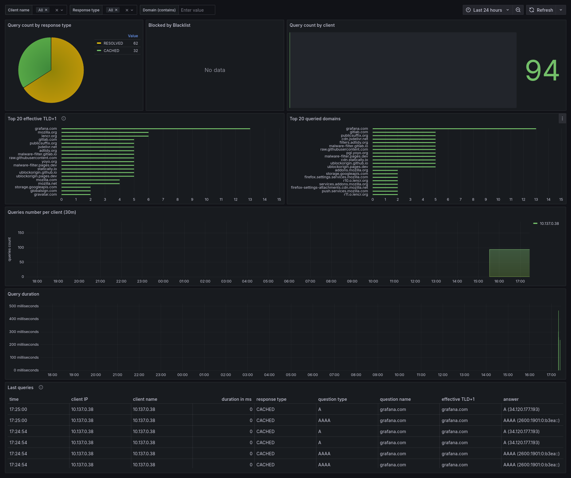

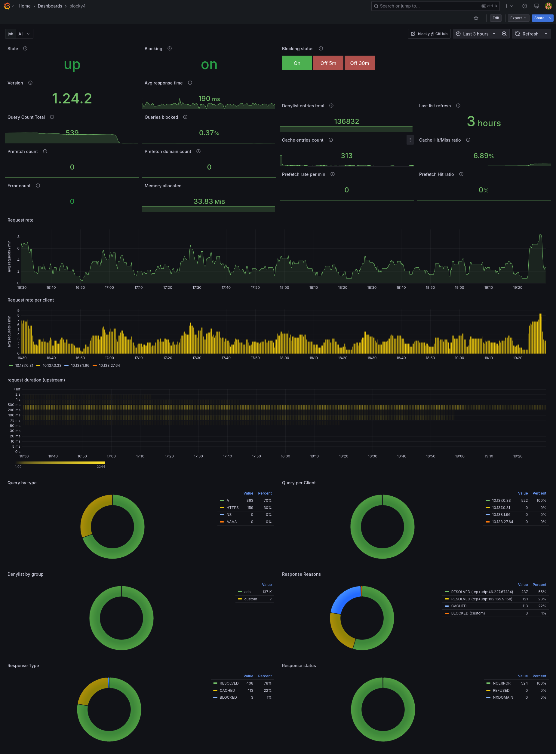

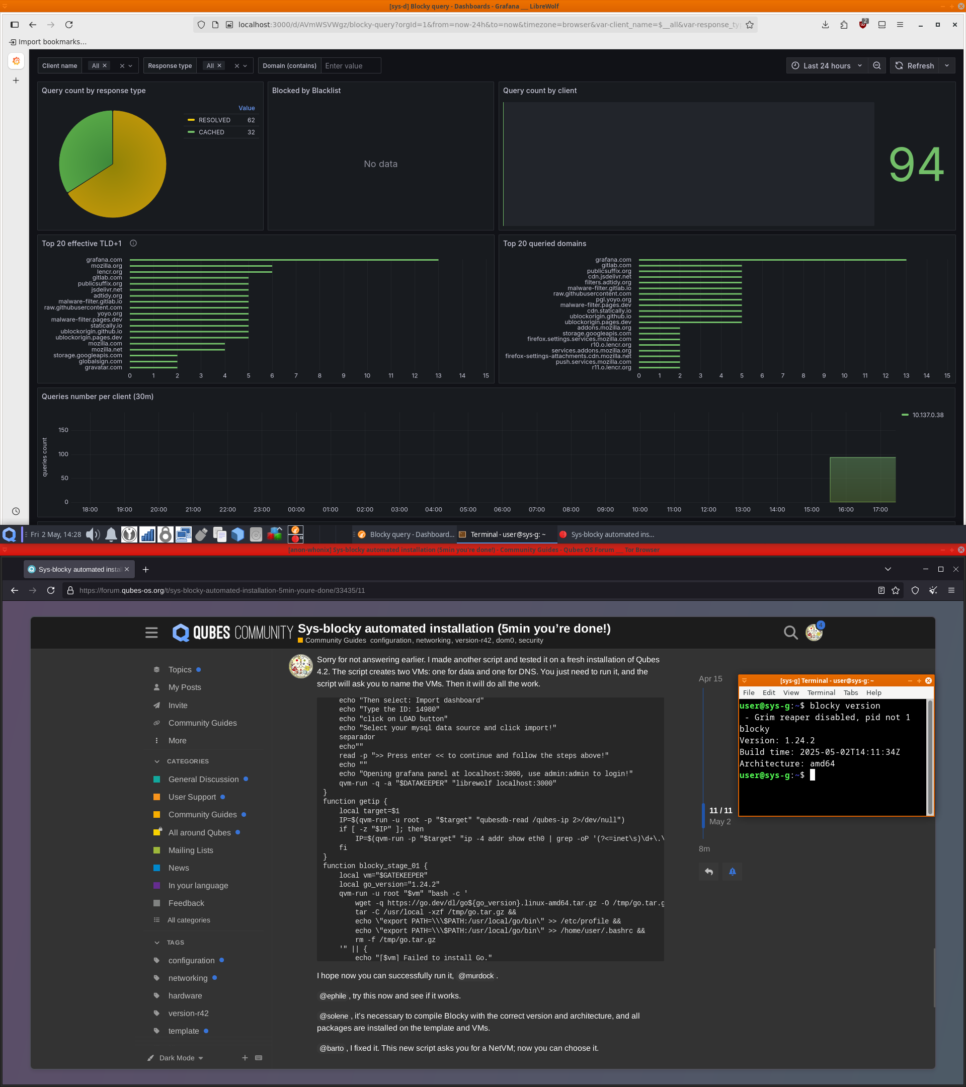

Hello everybody,
Sorry for not answering earlier. I made another script and tested it on a fresh installation of Qubes 4.2. The script creates two VMs: one for data and one for DNS. You just need to run it, and the script will ask you to name the VMs. Then it will do all the work.

	echo "Opening grafana panel at localhost:3000, use admin:admin to login!"
	qvm-run -q -a "$DATAKEEPER" "librewolf localhost:3000"

I hope now you can successfully run it, @murdock.
@ephile, try this now and see if it works.
@solene, it’s necessary to compile Blocky with the correct version and architecture, and all packages are installed on the template and VMs.
@barto, I fixed it. This new script asks you for a NetVM; now you can choose it.
