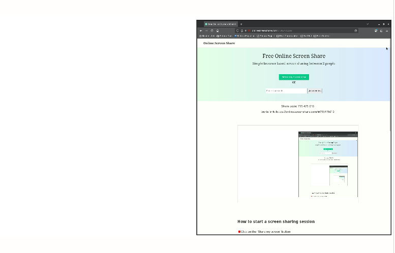

I’ve tried setting it in r4.3-rc but I don’t seem to get it to work. I used qvm-features dom0 gui-default-window-background-color black, but as seen in the attached screenshot, the colour is still white (many reboots later).
