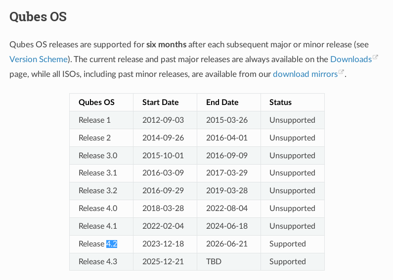

I think there is some confusion here. Whonix 17 is still supported on Qubes 4.2 until Qubes 4.2 reaches EOL, which is currently scheduled for 2026-06-21 (six months after the release of Qubes 4.3, per the standard Qubes release support policy).
(CC: @marmarek, @adrelanos)
This post is about Whonix 17 reaching EOL, not Qubes 4.2 reaching EOL. Qubes 4.2 won’t reach EOL until 2026-06-21 (six months after the release of Qubes 4.3, per the standard Qubes release support policy).

Version 17: The goal is to provide support for as long as Qubes R4.2 receives security support from Qubes and Debian.
This would be the time adw mentioned.
