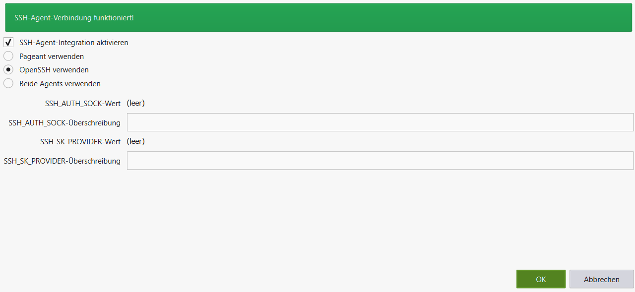

Do you have in KeePassXC the ssh-agent integration enabled?
