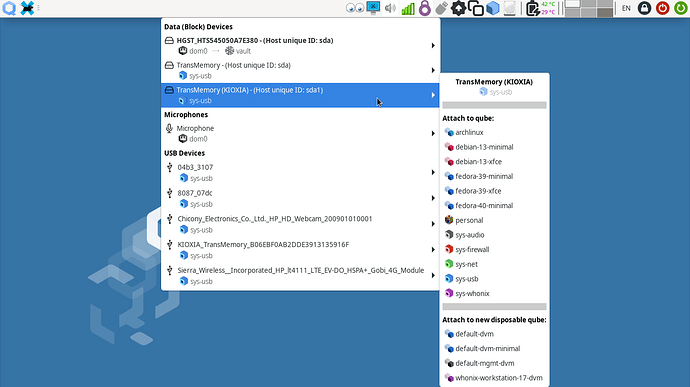

OK. So let’s provide some simple community guide to other issues. If you want to change the size of the menus for any reason (small screen, low resolution, …). The files you want to modify are either of /usr/lib/python3.11/site-packages/qui/qubes-devices.light.css or /usr/lib/python3.11/site-packages/qui/qubes-devices.dark.css depending on your desktop theme. In order to shrink it, you will have to change margin properties. Please refer to W3School guide if you need more information on CSS Margins.
If you want to add icon to USB devices (the old Qubes Devices GUI had one which is still on Qubes OS official guide). Add these two lines to /usr/lib/python3.11/site-packages/qui/devices/backend.py
@@ -158,6 +158,8 @@
return 'harddrive'
if self.device_class == 'mic':
return 'mic'
+ if self.device_class == 'usb':
+ return 'usblogo'
return ''
@property
The usblogo should be the name of png or svg icon. You could provide your icon via xdg-icon-resource(1)
Here is how my Qubes Devices looks like after all of the Tweaks:
