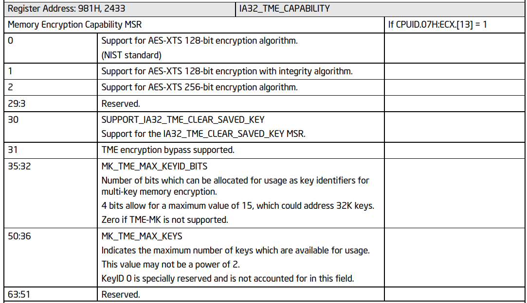

Unfortunately, you will be greeted by this blocker from Intel:

The current NovaCustom models (NV54/56) do not support TME:

For Qubes OS + Coreboot + Heads, in addition to the limited hardware selection, you may also need to think about TME
If you do want TME, you must also trust the hardware vendor’s implementation, similar to the SED vs. LUKS situation
TME is reliably available on SKUs using Intel vPro® Enterprise (at the moment)
Intel vPro® Enterprise includes Intel AMT, whereas Intel vPro Essentials, currently used on the NovaCustom NV54/56 models’ SKUs, have Intel® Standard Manageability (ISM), a subset of Intel AMT
The mobile SKUs after Meteor Lake, which is what the NovaCustom NV54/56 currently use, also follow this HSI-3 = no TME = ISM or HSI-4 = TME = AMT pattern, even the recently announced Nova Lake at the beginning of this year
