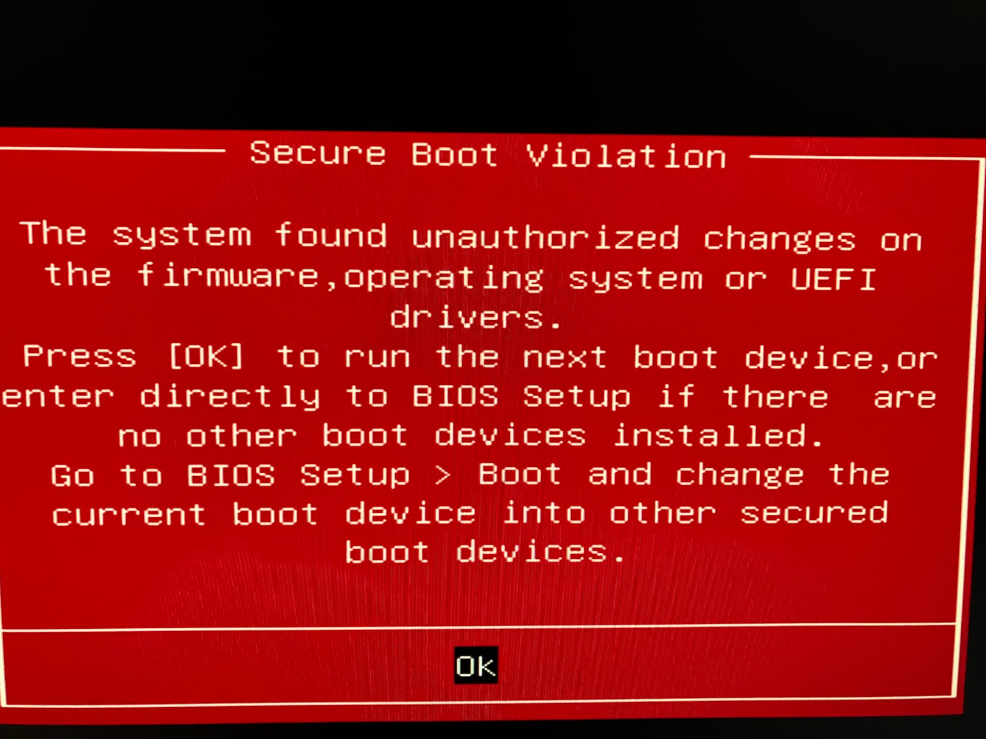

On trying to install Qubes, this windows popped up.
I didn’t get such a screen installing Ubuntu.
My computer: Asus ProArt x870E, MMD 9900X.
Secure boot is on.
Win 10, Win 11, Ubuntu.
What do you think?
I have not experimented installing Qubes with Secure Boot turned on, with UEFI. When I see a message like this. I would turn off Secure Boot, enable Legacy boot. I think there maybe an option to install with UEFI, just not me.

If I’m not mistaken, it’s because Ubuntu has secureboot key recognized, but QubesOS doesn’t.
I tend to rely on other mechanism than secureboot, but I think the documentation would have more information on this topic.

@Qubeslinux, your UEFI bootloader is doing exactly what it was designed to do.
Qubes OS was not enrolled in your Secure Boot whitelist.
You have a choice. Either enroll Qubes OS’s grubx64.efi manually (it can be done, it just requires a lot of technical know-how), or disable secure boot.
