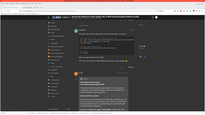

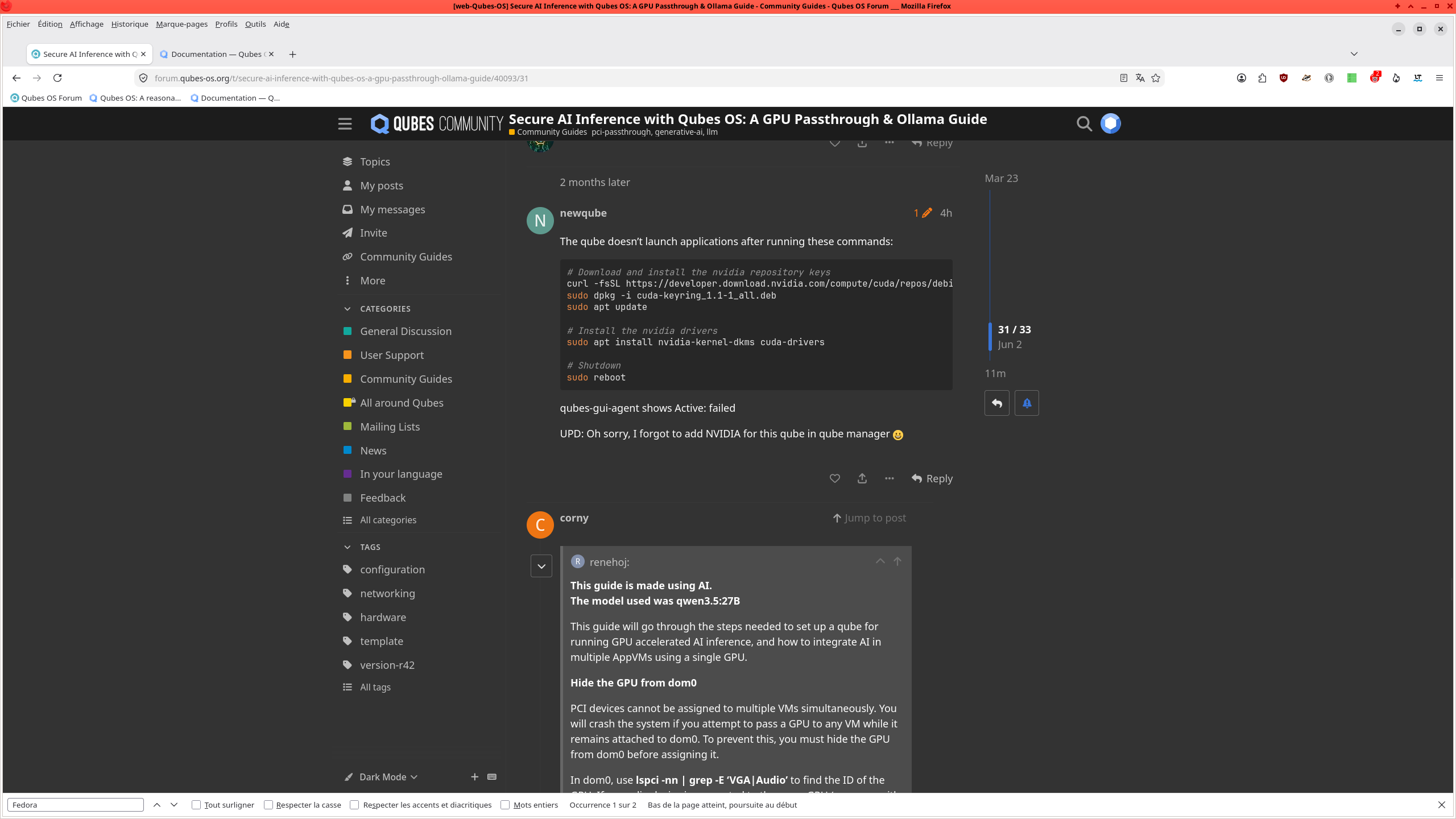

The qube doesn’t launch applications after running these commands:
# Download and install the nvidia repository keys
curl -fsSL https://developer.download.nvidia.com/compute/cuda/repos/debian13/x86_64/cuda-keyring_1.1-1_all.deb -o cuda-keyring_1.1-1_all.deb
sudo dpkg -i cuda-keyring_1.1-1_all.deb
sudo apt update
# Install the nvidia drivers
sudo apt install nvidia-kernel-dkms cuda-drivers
# Shutdown
sudo reboot
qubes-gui-agent shows Active: failed
UPD: Oh sorry, I forgot to add NVIDIA for this qube in qube manager :grinning_face:
