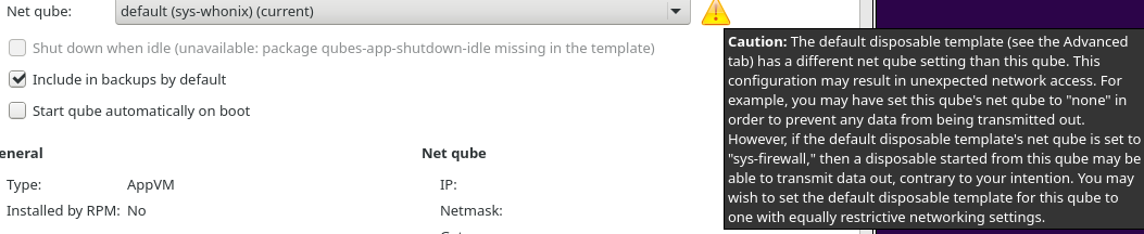

There is a warning about this in the qube’s settings:
Caution: The default disposable template (see the advanced tab) has a different net qube setting than
this qube. This configuration may result in unexpected network access.
For example you may have set this qubes net qube to “None” in order to prevent any data from being transmitted out.
However, if the default disposable template’s net qube is set to “sys-firewall”, then a disposable started from this qube
may be able to transmit data out, contrary to your intention. You may wish to set the default disposable template
for this qube to one with equally restrictive network settings.
