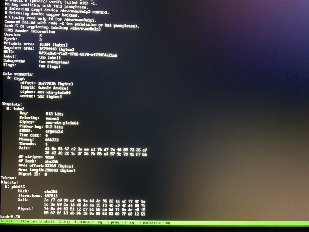

Look into luks - it is not a qubes os topic by itself. Maybe start with a cryptsetup luksDump /dev/sdX
Yeah I tried that and it seems to be sane somehow. Honestly.. I’m about to give up and reinstall, because it seems no one has ever encountered this specific problem before. It can’t accept any disk password without the initramfs being regenerated but I don’t think I can do that without unlocking the disk password first.

Do you at least have an idea of what’s happening here? I have a few guesses but I’m not really sure. The luks header doesn’t look corrupted and the password is definitely not wrong so I’m stuck here. Plz help on this.
