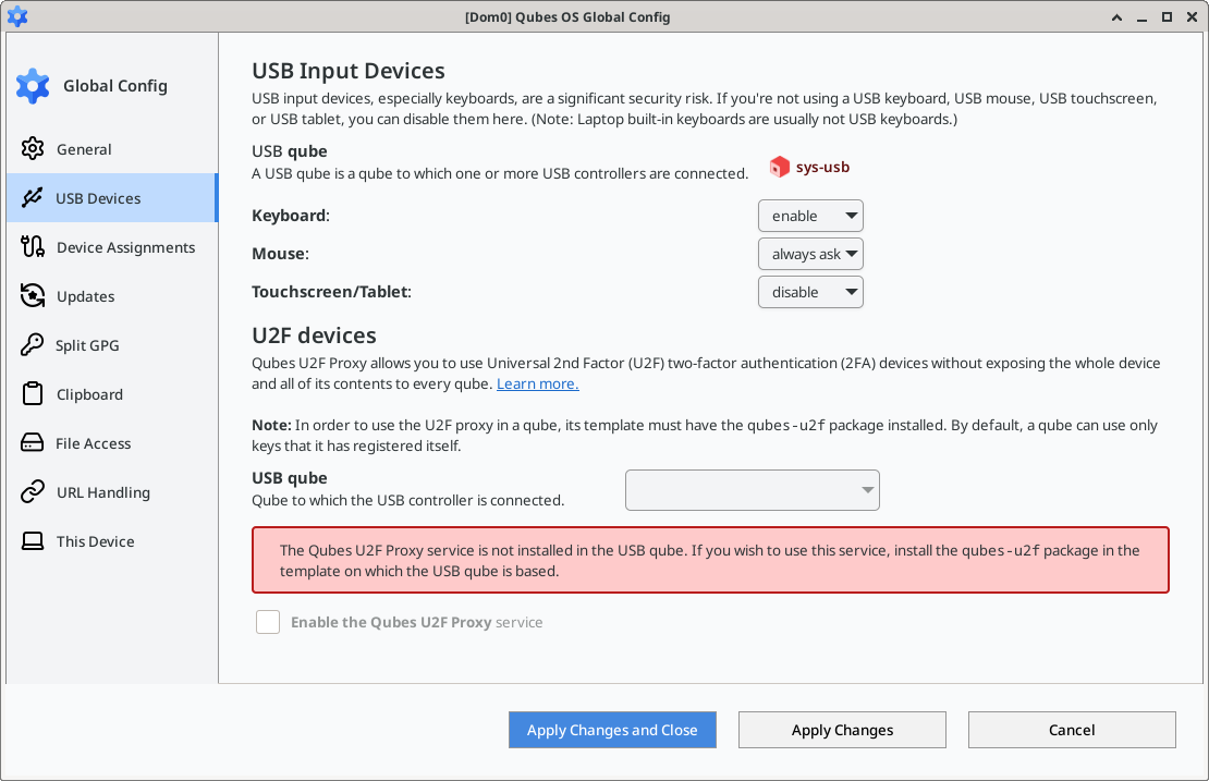

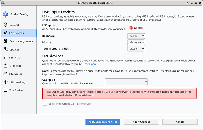

Alternatively there is also Qubes Global Config where you can adjust the configuration:
Thanks for pointing this out. I have reverted my changes and used the GUI tool. Interestingly the tool noticed my addition and warned that it may override any changes made in the tool.
