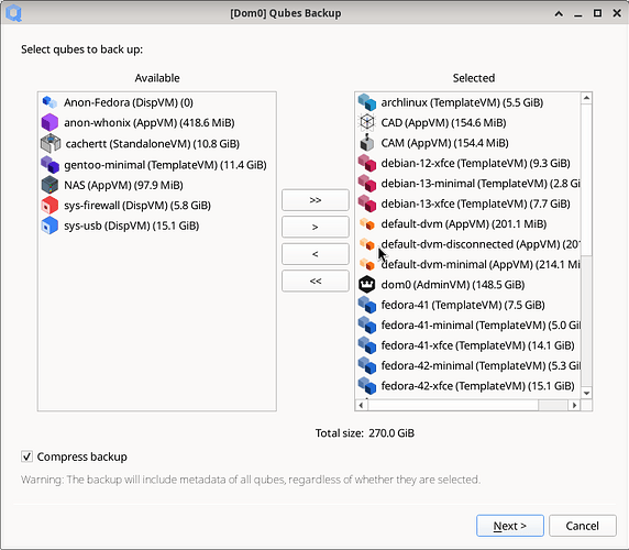

Some update on this. The PR for making auxiliary compression filters available for Qube Backup GUI and backup profiles are merged and released for Qubes OS r4.3 testing. Here is a screenshot:
As soon as user installs any of xz, pigz, zstd packages, they will be available in compression filter drop-down menu. There will be no additional options added to Qubes Backup GUI (e.g. compression level). If anyone wants to fine-tune compression options, it is possible to create a dummy bash script of the same name at ~/bin and point it to the original binary with custom options. e.g.:
