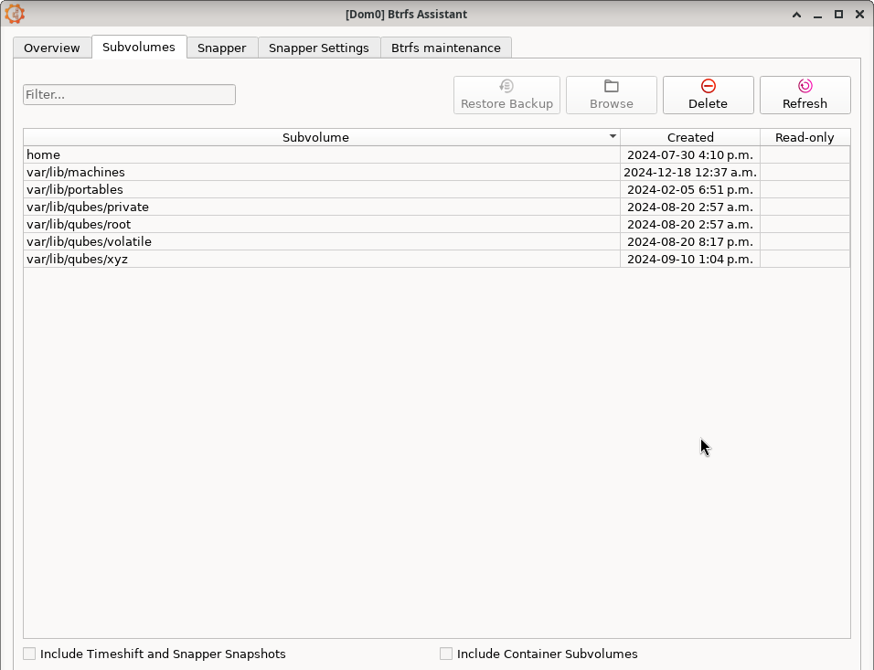

BTW, I would recommend taking a look at Btrfs Assistant GUI while you are testing. It would be very convenient for 1st time Btrfs users. Or at least, it would provide good screenshots for educational purposes and help the community understand it better.
You mean the “blivet GUI” approach on which BTRFS has a special menu and you can add mountpoint through subvolumes? I’m on it :smiley:
No. It is a separate program which could be installed in dom0 (after installation):
sudo qubes-dom0-update btrfs-assistant
It allows easy management of subvolumes, snapshots, maintenance, …

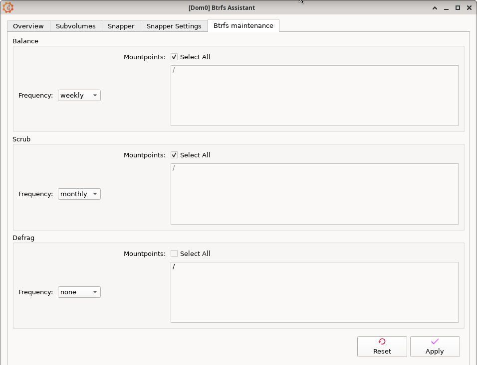

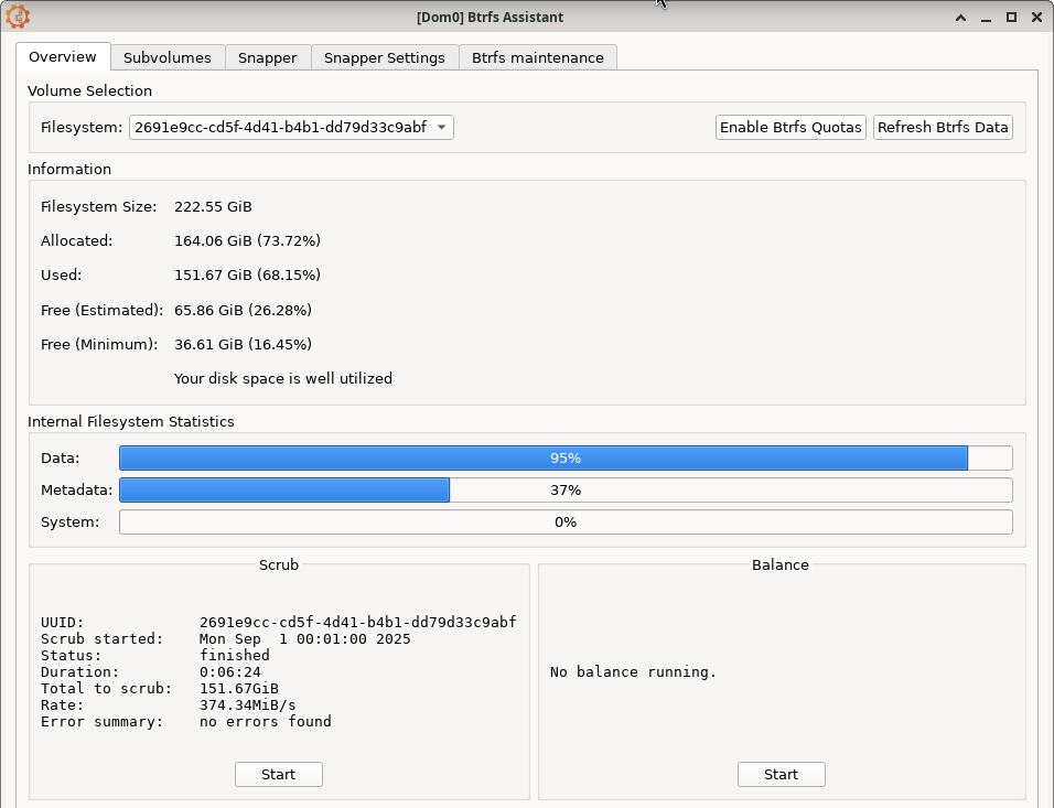

BTW, if you look at the 1st screenshot (Overview), it becomes evident why BTRFS requires periodic scrubbing and balancing otherwise its performance could be degraded. Specially if it is near full. It has two values for Free Space. Estimated and Minimum. And after periodic balancing, it will be almost similar.
With default Fedora installation on BTRFS, a package called btrfsmaintenance should be installed which contains systemd timers and units to automate it.

Not only for bittrot checking but also for metadata, checksums, … and other errors which might occur due to power loss, crash, etc. I would do it 4 times a year. It won’t hurt.
Yes. If you have a single drive with a lot of free space, balance should not be required. Otherwise balance results on chunks being compacted and re-arranged. Which is very good for the overall performance of the volume which is almost filled. An example:
