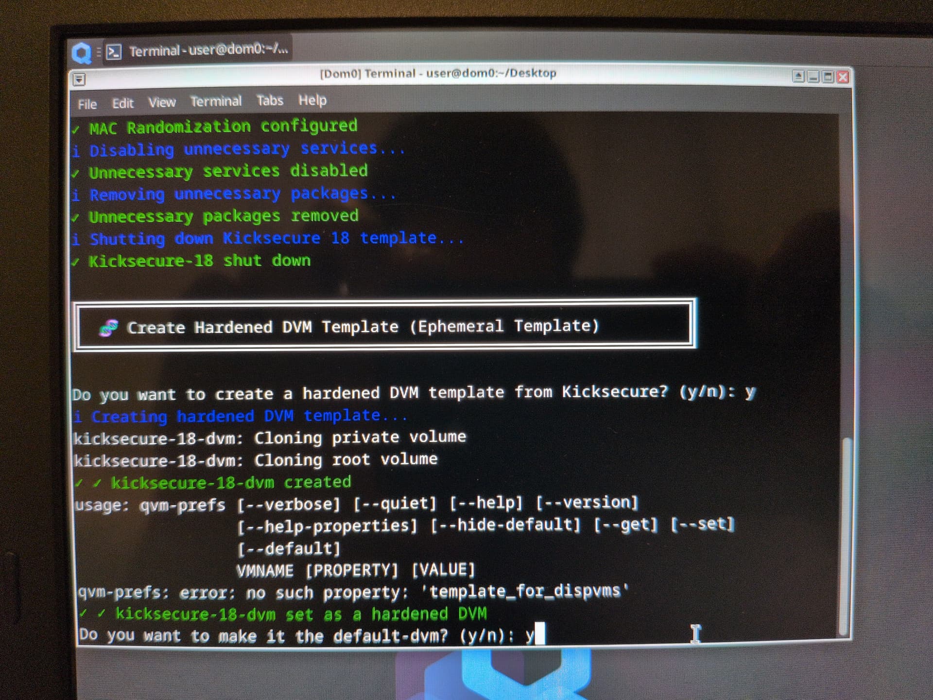

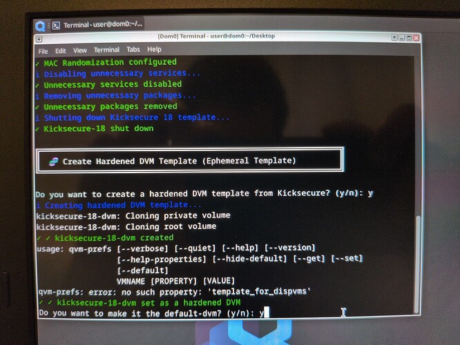

I already installed the Kicksecure-18 template by the time I ran
4) Install Kicksecure + set as default but something odd also just happened. I’ll show you a screenshot this time. It happened when I entered “y” when prompted to create a hardened DVM template from Kicksecure.

  6. Creation errors (template_for_dispvms and rw=False):
    • First error: The script used qvm-clone, which produced a TemplateVM, but the property requires an AppVM. Before replacing the old line, you should first remove the existing kicksecure-18-dvm VM (if it exists) because it was created by the previous script as a TemplateVM and will cause conflicts if not deleted. Then, replace the old qvm-clone line with the following:
      Old line (to be removed):
      qvm-clone kicksecure-18 kicksecure-18-dvm
      New lines (to replace it):
      qvm-create --template kicksecure-18 --label red kicksecure-18-dvm
    • Second error: The rw=False property on root is unstable and causes issues, so it was removed and will not be reinstated. The script will rely solely on template_for_dispvms=True.
