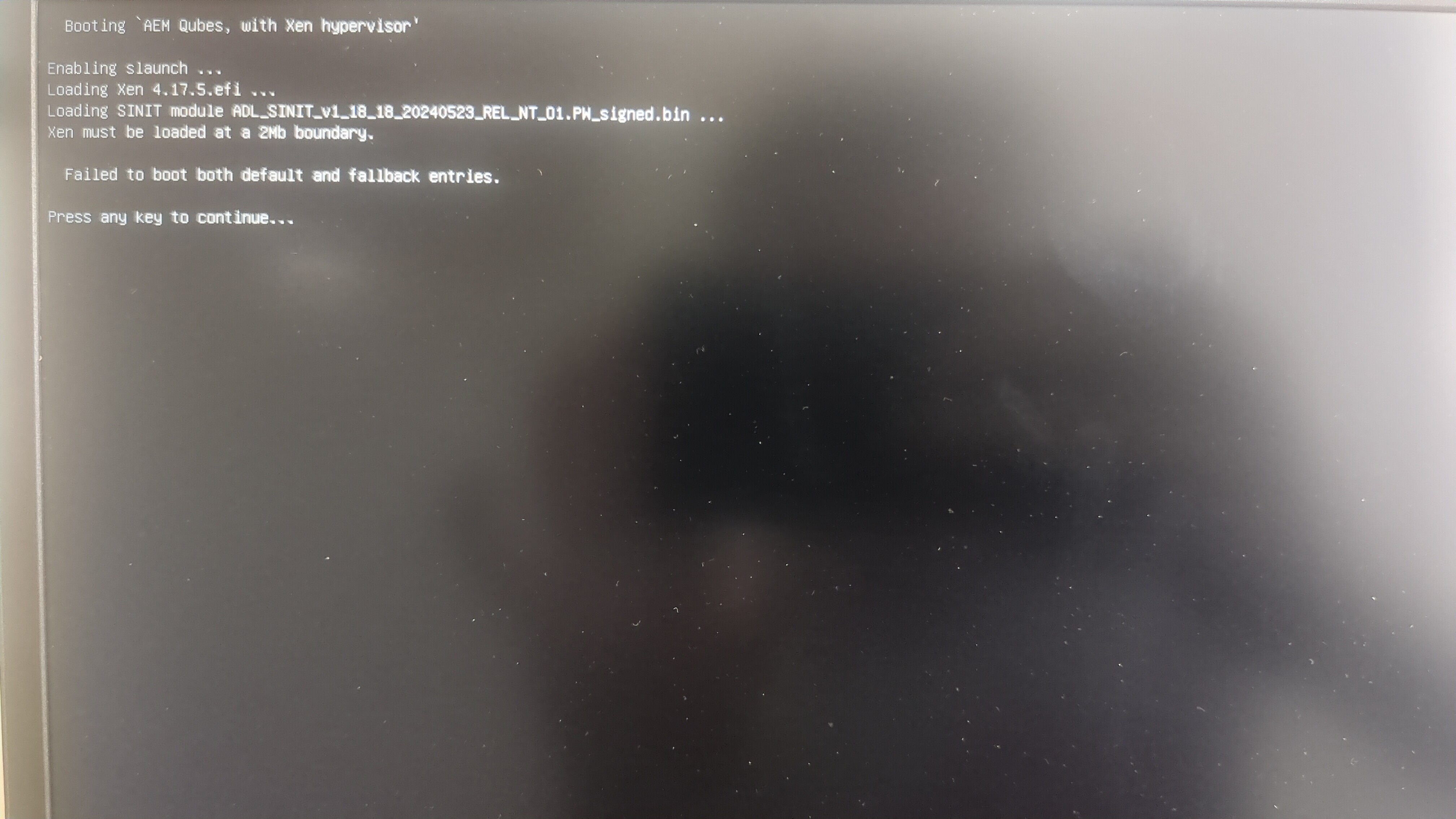

I have the same error, also on Samsung, I’ve tried the UEFI troubleshooting as well to no avail. There is very little explaining how to solve this. I’m trying to use AEM, and I think the xen binaries are up to date.
Also, after failing to boot into AEM, when the non-AEM boot option is selected it takes forever to boot (as in never successfully done). if i dont fail to boot into AEM, this error doesnt occur.
