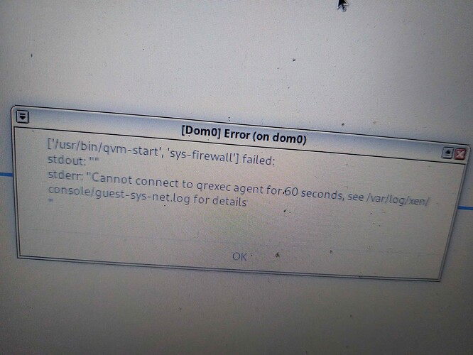

I get an error at the end of the Qubes OS installation network setup as you can see in the picture. I can only click on the OK button and the system starts, everything works except the Qubes because I do not have the firewall and the network is not available or displayed because it failed during the installation.
I have often read that I have to get an Ethernet cable because some do this during the installation because otherwise I think no network is recognized, I have ordered one which should come in the next few days but until then someone can tell me if it can be simply fixed or if there are other possibilities.
['/usr/bin/qvm-start', 'sys-firewall'] failed:
stdout: ""
stderr: "Cannot connect to qrexec agent for 60 seconds, see /var/log/xen/console/guest-sys-net.log for details"

Provide the guest-sys-firewall log:
How should I share the log if I cannot connect to the Internet to upload it somewhere?
CPU is kinda bad, just an ASUS Vivobook with an AMD Ryzen 3 and 12GB of RAM.
Manually type it. In addition, create an HCL report and manually type that here too:

Before you start typing, are you able to verify that other qubes can start correctly?
  • Are other qubes running?
  • If you select the Q menu, does Terminal or file manager open in the Vault qube? Do you see errors?
If Vault does not work, then there is a more important problem than the network!
If you have a better suggestion to share logs with a nonfunctional sys-firewall, provide it.
Sorry, @FranklyFlawless … I was just imagining someone trying to type out the whole log file!
There is the use of a removable USB device, if another network-connected device is available… but that would be best used with another qube.
OTOH, if Vault works, then my next steps would be:
  • (maybe ) Does sys-net run? sys-usb? (I’m not sure why we are only seeing sys-firewall errors… is there only WiFi on USB? I have no possibility to see how such a configuration works)
  • OP tries looking at the log file in Dom0
    • ‘tail ’ to look at the last few lines
    • ‘grep -i error ’ to search for lines containing the string “error”
    • ‘grep -i failure ’ to look for the string “failure”
    • ‘less ’ to look through the whole file
If nothing is obvious, then (from memory) connect a usb key to another qube - not Vault - with network=none, qvm-copy, transfer from qubes-incoming, and send.
If Vault doesn’t work… pretty sure I had a similar problem , and even went looking at sys-firewall, when my IOMMU was disabled due to a failed CMOS battery, so no qubes were starting at all.
