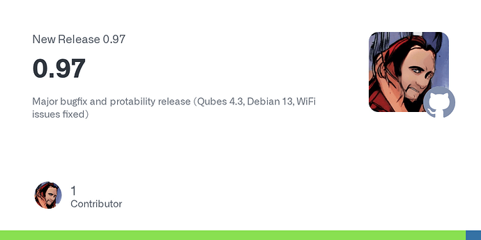

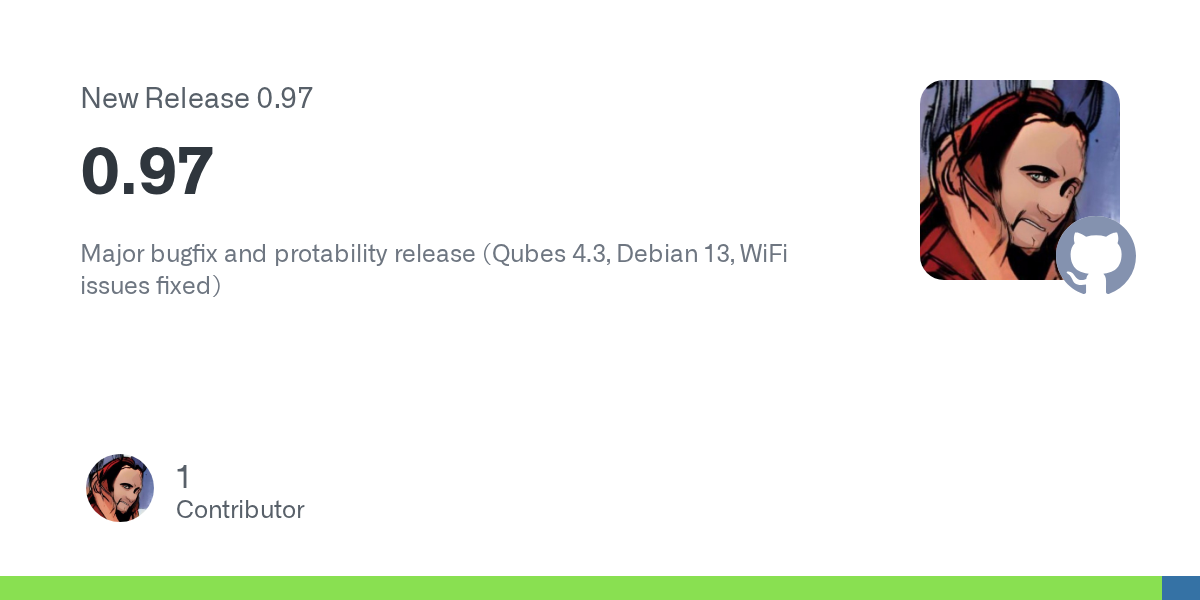

now for 4.3
if you REALLY want me to backport bugfixes to 4.2 just let me know, but I’d prefer to skip :slight_smile:
