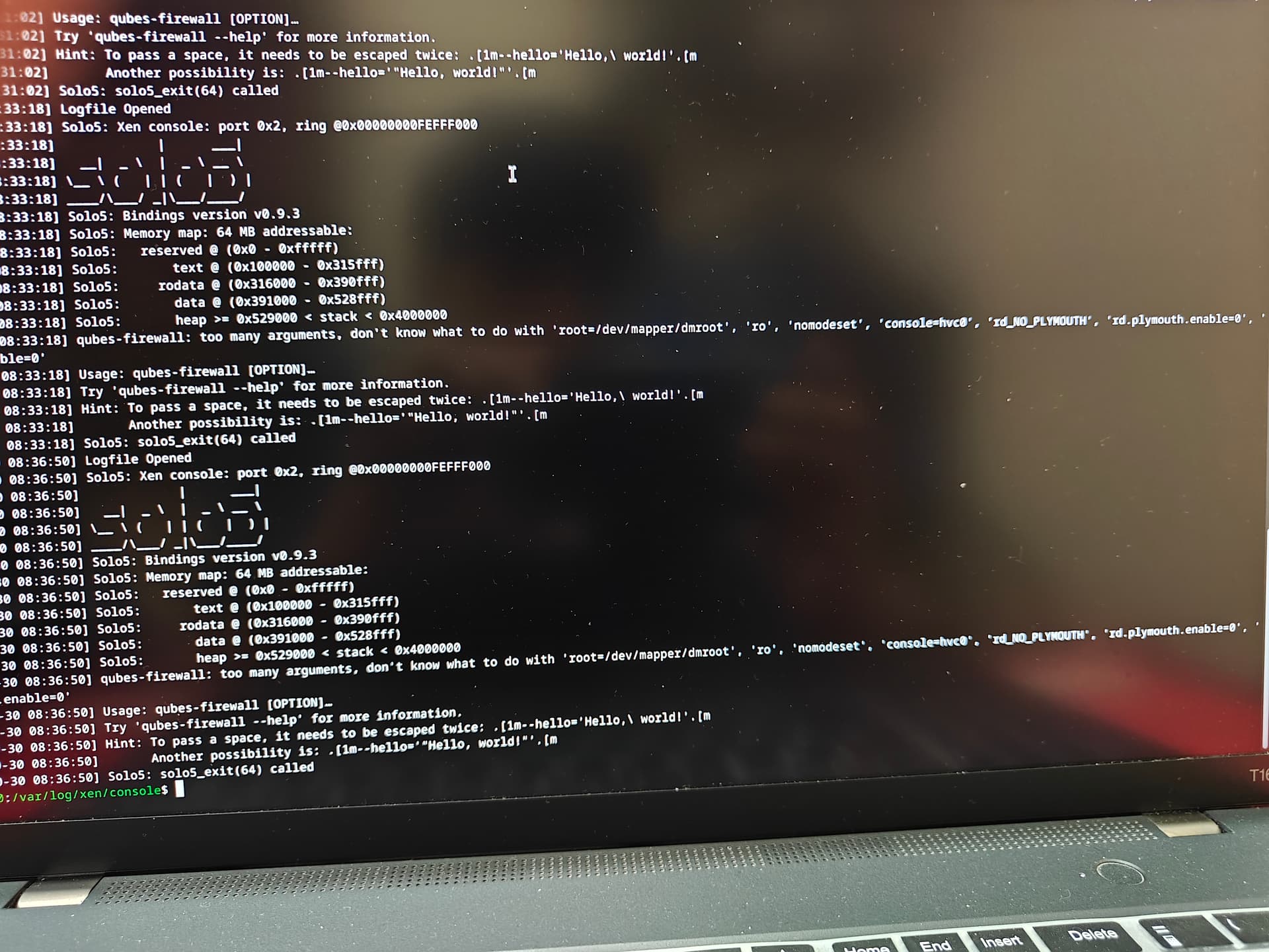

Build with docker following instructions, and tried to start results in following error
These are logs from guest/mirage-firewall.log
The additional arguments are provided by Qubes for linux kernels, you need to set no-default-kernelopts (see GitHub - mirage/qubes-mirage-firewall: A Mirage firewall VM for QubesOS).

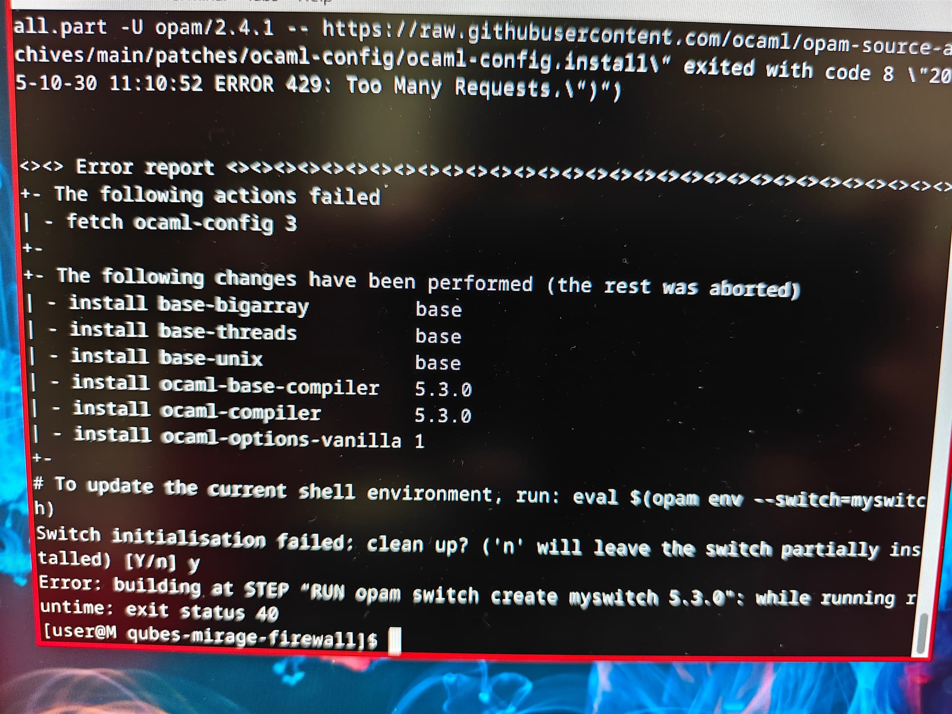

Actually error in build process failed to get extra source ocaml-config.install I think I didn’t check build process and did everything after trying again I am having error during build with both docker and podman

Did you build or downloaded directly from GitHub.my build process keep failing at fetch ocaml config 3 step Run opam switch create my switch 5.3.0
I downloaded the pre-built uni-kernel from Github. But I will try to build it myself and report back.
You are not trying to fetch via Tor?
No
The command at the top of your screenshot shows a failure due to too many requests. Maybe there is other people that use GH on your local net, or maybe it should work after a delay?
Podman or Docker should cache a lot of work, so a succesful build should already have a working ocaml.

Update: I’m an idiot – just swapped the file locations from dom0 to a dispVM I copied the files to and it worked. But now I’m having different issue.
When I run the mirage-firewall VM, it shuts down immediately and logs give me this:

[2025-10-31 17:00:31] qubes-firewall: too many arguments, don't know what to do with 'root=/dev/mapper/dmroot', 'ro', 'nomodeset', 'console=hvc0', 'rd_NO_PLYMOUTH', 'rd.plymouth.enable=0', 'plymouth.enable=0'
[2025-10-31 17:00:31] Usage: qubes-firewall [OPTION]
[2025-10-31 17:00:31] Try 'qubes-firewall --help' for more information.
[2025-10-31 17:00:31] Hint: To pass a space, it needs to be escaped twice: .[1m--hello='Hello,\ world!'.[m
[2025-10-31 17:00:31]       Another possibility is: .[1m--hello='"Hello, world!"'.[m
[2025-10-31 17:00:31] Solo5: solo5_exit(64) called
Edit again:
I just need to slow down :sweat_smile:
This resolved my issue!
For some reason running the entire command at once didn’t include those two lines at the end.
