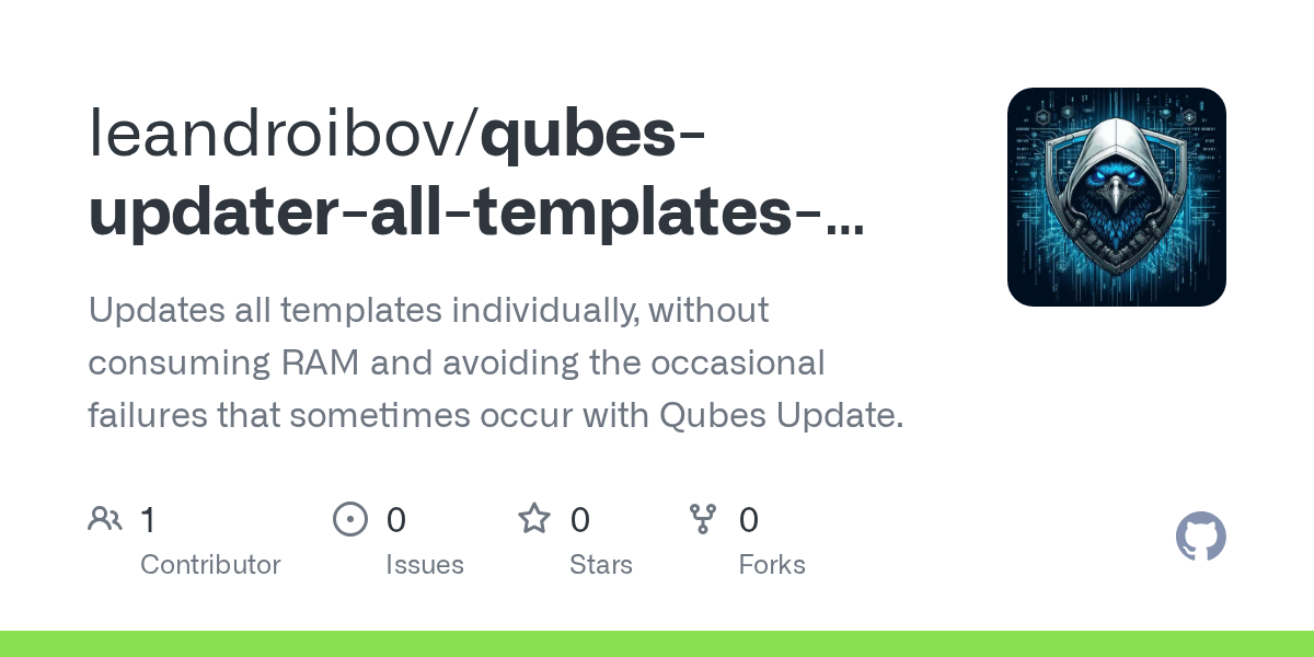

It’s a script intended to be placed in /bin on dom0 so that, just by typing a command in the dom0 terminal, you can start updating every template currently present in the system. It can be run with sudo ./updater.sh! The script updates the templates one at a time, not several simultaneously. The problem with Qubes’ built‑in updater is that it opens a bunch of templates perhaps four or five at once consuming a lot of RAM. Moreover, it fails many times, and the usual fix is to open each template manually and run sudo apt update and sudo apt upgrade.
What the updater.sh script does is exactly that, but it iterates over each template and executes:
qvm-run <template_name> “sudo apt update && sudo apt upgrade”
One template at a time, so it doesn’t hog memory the way Qubes Update does! Users with limited RAM or who are already using a lot of RAM can run the updater without heavily impacting their system.
How to install
Download the updater and updater.sh shell scripts from
Example using the vault AppVM, assuming your Qubes user name is user:
In the default vault AppVM, create a folder called scripts under /home/user/ → /home/user/scripts.
Copy updater and updater.sh into that scripts folder.
