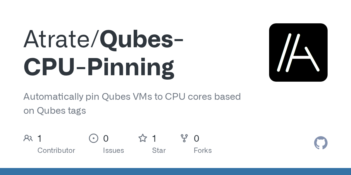

Qubes Cpu Pinning: automatically pin CPUs for VMs
Hey there. I’m releasing yet another of “my” scripts for everyone to use :slight_smile: .
This time “my” is in quotation marks, as it’s just a small modification made to the scripts by @noskb and @anon40243023 in CPU Pinning Alder Lake.
Regardless, it has that small modification (allowing for soft pinning) so I thought I’d share. I also want to have a “recommended” way of CPU pinning for my Window Boost script: Qubes Window Boost: Dynamic, window focus-based CPU pinning

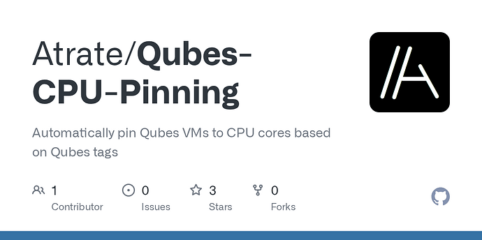

Update: I’ve fixed a bug that caused some domains not to get their pins set correctly, some of the time. The update is live on Github.
@anon40243023 could you try to verify this again? I’ve been experimenting with soft-pinning on credit2, observing the cores with GitHub - Atrate/xen-cputop: A bash script that helps display total per-core system load on Xen · GitHub and it looks to be working.
