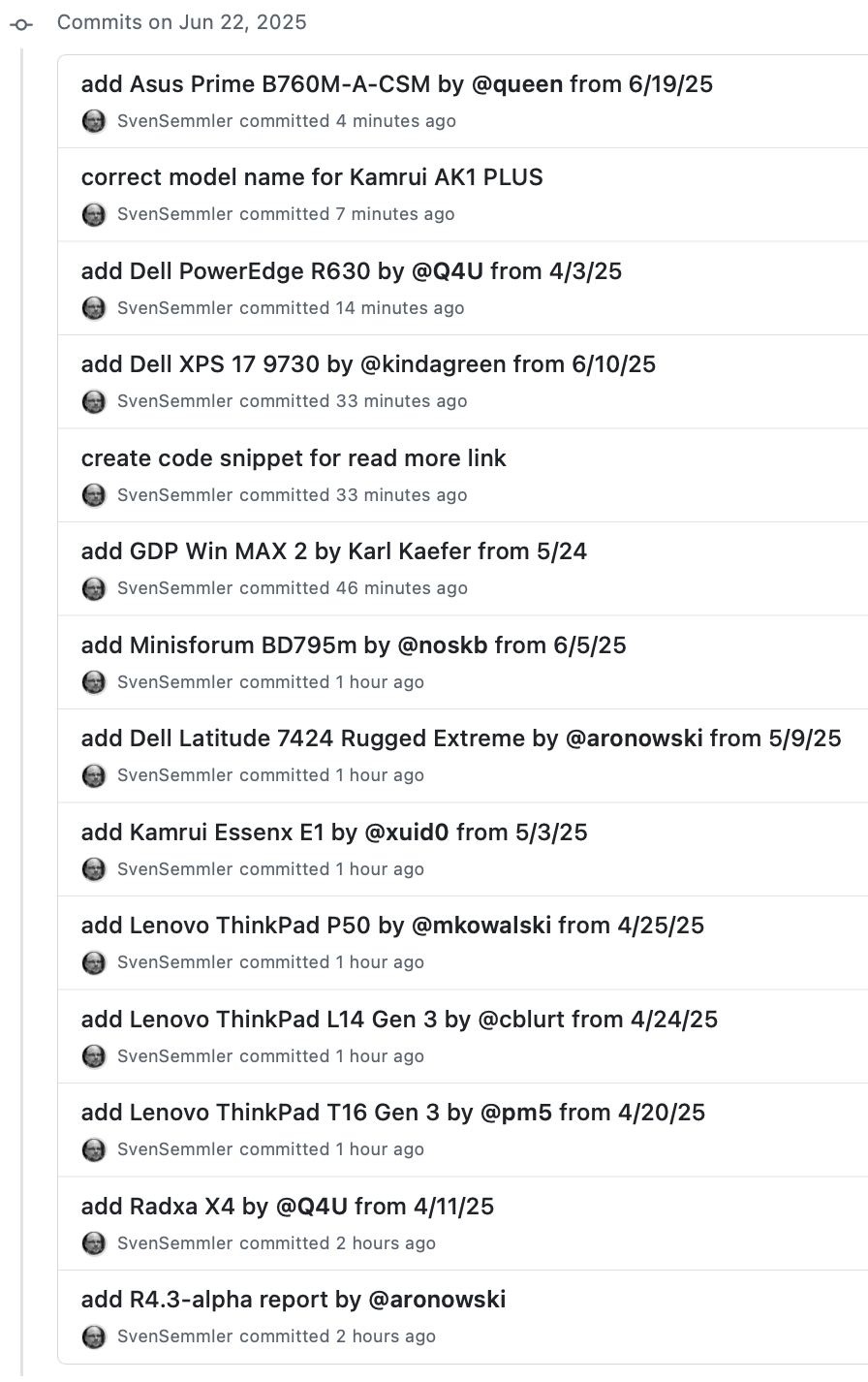

There is something wrong with whatever the update process is, by the looks.
Going through the GitHub commit history, some updates make it to the HCL database and others don’t.
As far as I can tell, most (if not all) of the commits on Jun 22, 2025 have not made it to the HCL.
Whereas most (if not all) of the commits on Mar 29, 2025 did make it to the HCL.
Some of the commits made on Mar 8, 2025 do make it to the HCL, but some do not.
For example, commit 21858eb1907ea80c6e2a0cb1e0d9a11c1fd096ea (the Google Pixel 2025 by @q4u) did make it to the HCL, including its incorrect hardware model name. But a71a18f0b764c15cf00ebc1a37afdb36703ee393 (the Dell Inspirion 5582 by @marcos-morar) does not make it to the HCL.
Even your commit 038e1be0bd6a490ec5a287a08563668ba58ffa16 on Mar 9, 2025 @Sven does not make it to the HCL, so the Google Pixel 2025 by @q4u is still listed in the HCL as the Google Pixel 2015.
