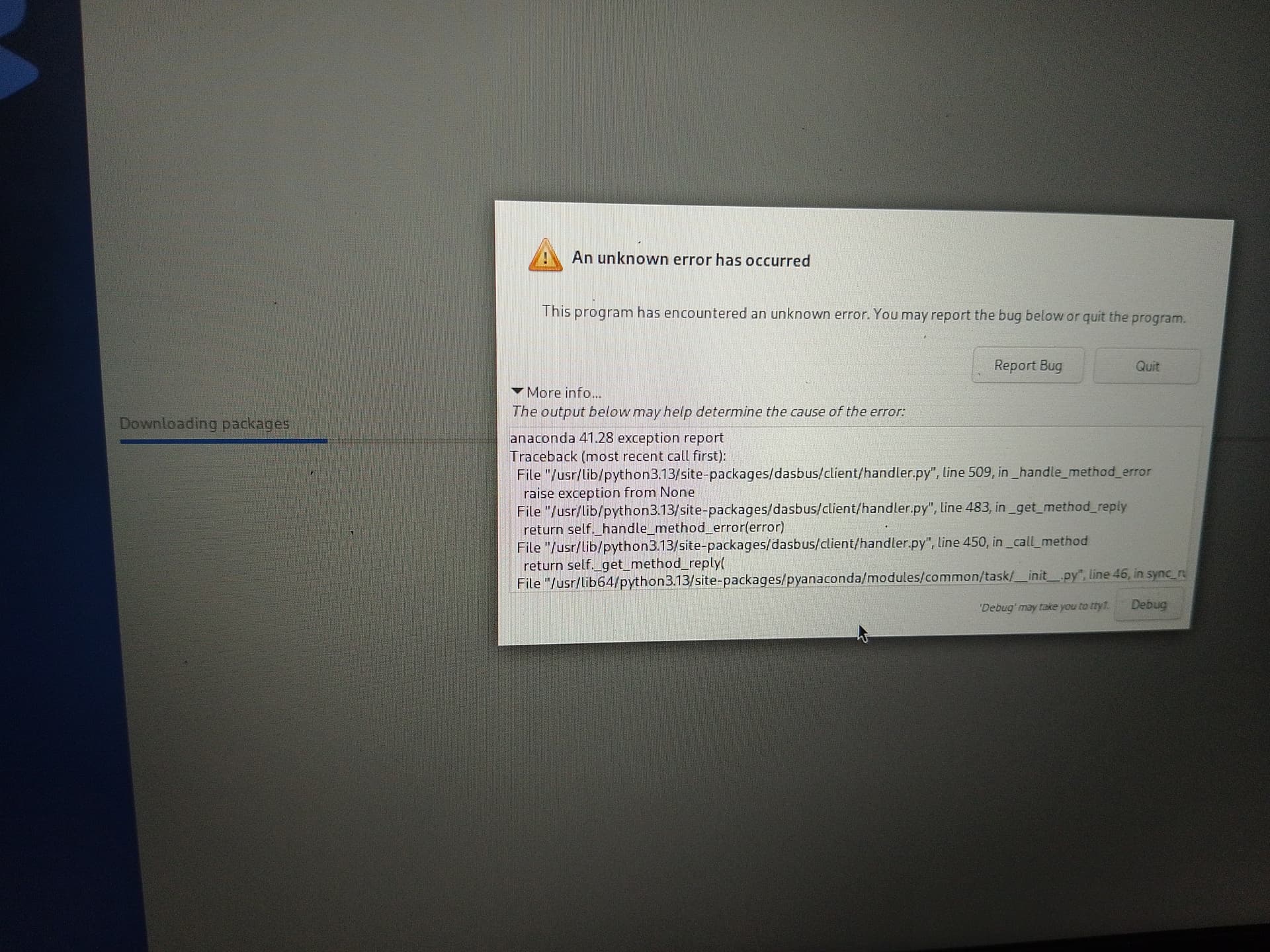

Problem when compliting the setup qubes os
hi, anyone can help me, im stuck on the downloading packages when i was completed the downloader, idk what the problem , i alr connect the ethernet plsssss help
It isnt clear what your problem is, so it’s not possible to help.
Can you explain what packages you are trying to download and what you
mean by “completed the downloader”.
OK, so this is how I want to install Qubes OS, the first thing I do is create an ISO image on my flash disk, when I enter grub mode I select the one above. Well, I’ve filled in everything from username, disk, location, etc. I pressed the last option to install it, but it stopped downloading packages, I don’t know what the problem is… What do you need so I can solve this problem? Thanks
Which version of Qubes OS is it?
“Downloading” here actually means “copy from the ISO”. That’s confusing.
I cant see that image - could you summarise for me what it shows?
Did you validate the ISO image before installing? There are three checks
you can carry out: on the image file, check the sha256 hash and
confirm the detached signature - both detailed here;
on the install image, select the option to check the disk before
installation.
its 4.3.0
lemme check, wait…
i alr check, and same
is there no way for me to complete the installation progress? To be honest, I’ve also tried the latest version, but it doesn’t appear on my flash disk (boot option in bios).and I tried 4.3.0 and it worked, but it always got an error in installation progress
Who can say?
As you have not said what the problem is or answered questions put to
you it’s difficult to help.
huh…OK, I will detail my problem/steps for booting… the first thing I did was download the l ISO of qubes 4.3.0 and check the sha256 (this is correct as on the website and which I installed). I started burning the iso using dropfus (I used the android app because there is no more os on my laptop). everything went smoothly… I have created a user account, etc. When I started start installation, it didn’t run smoothly because I was stuck downloading packages as I sent the photo above… I’ve turned off secure boot, etc… and what’s wrong here? To be honest, I’m not sure it will work, because my laptop uses Nvidia and the igpu is intel (just know that nvidia is sometimes weird on linux)
oke the problem is fix, thanks @unman :), the problem It’s located on my corrupted flash disk and I tried buying a Sandisk flash disk (it worked). oh
I’ve already asked you to summarise what is in the screenshot -
referring to it again does not help me.
Did you use the option to test the install medium?
What does “stuck downloading packages” mean?
Did you see any errors?
everything is finished… and the error occurred because my flash disk was corrupt, thanks🙏
