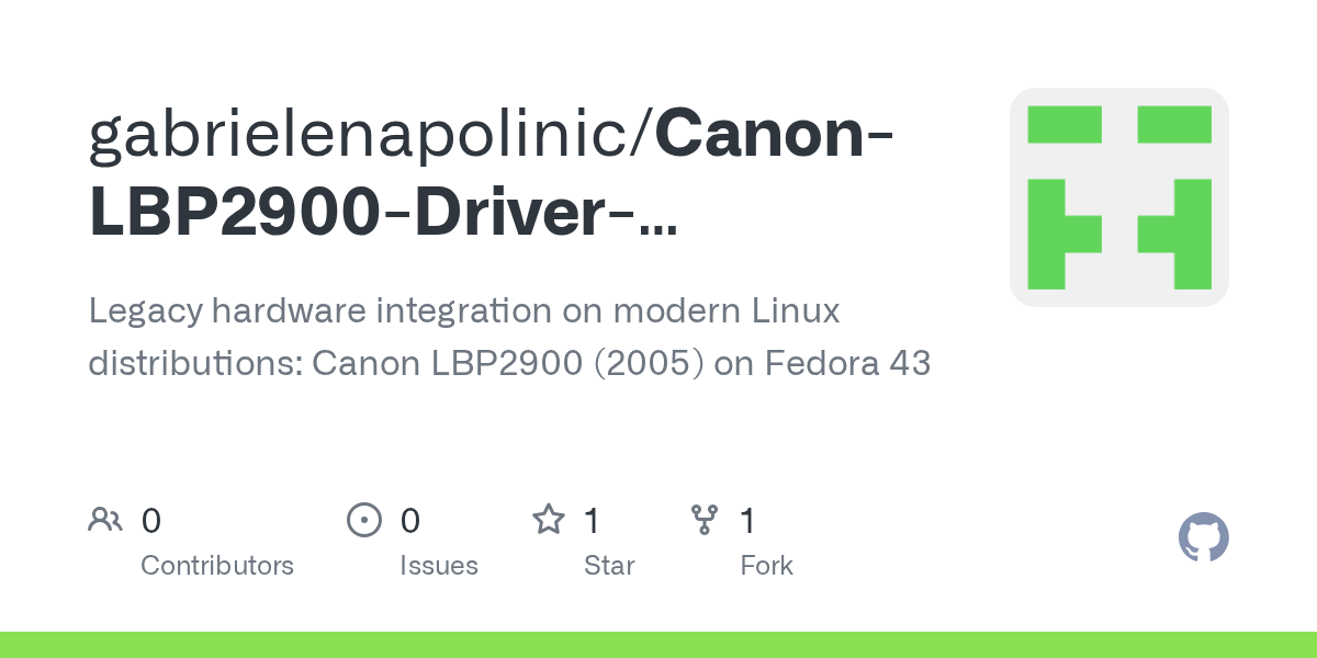

I looked at the readme of the GitHub project:
It’s likely that the official proprietary drivers don’t work as stated in the readme and maybe the reverse engineered FOSS drivers also don’t work or are outdated since hobbyists don’t always have time to maintain such projects. (The linked project uses a different project which got its last update 7 years ago)
