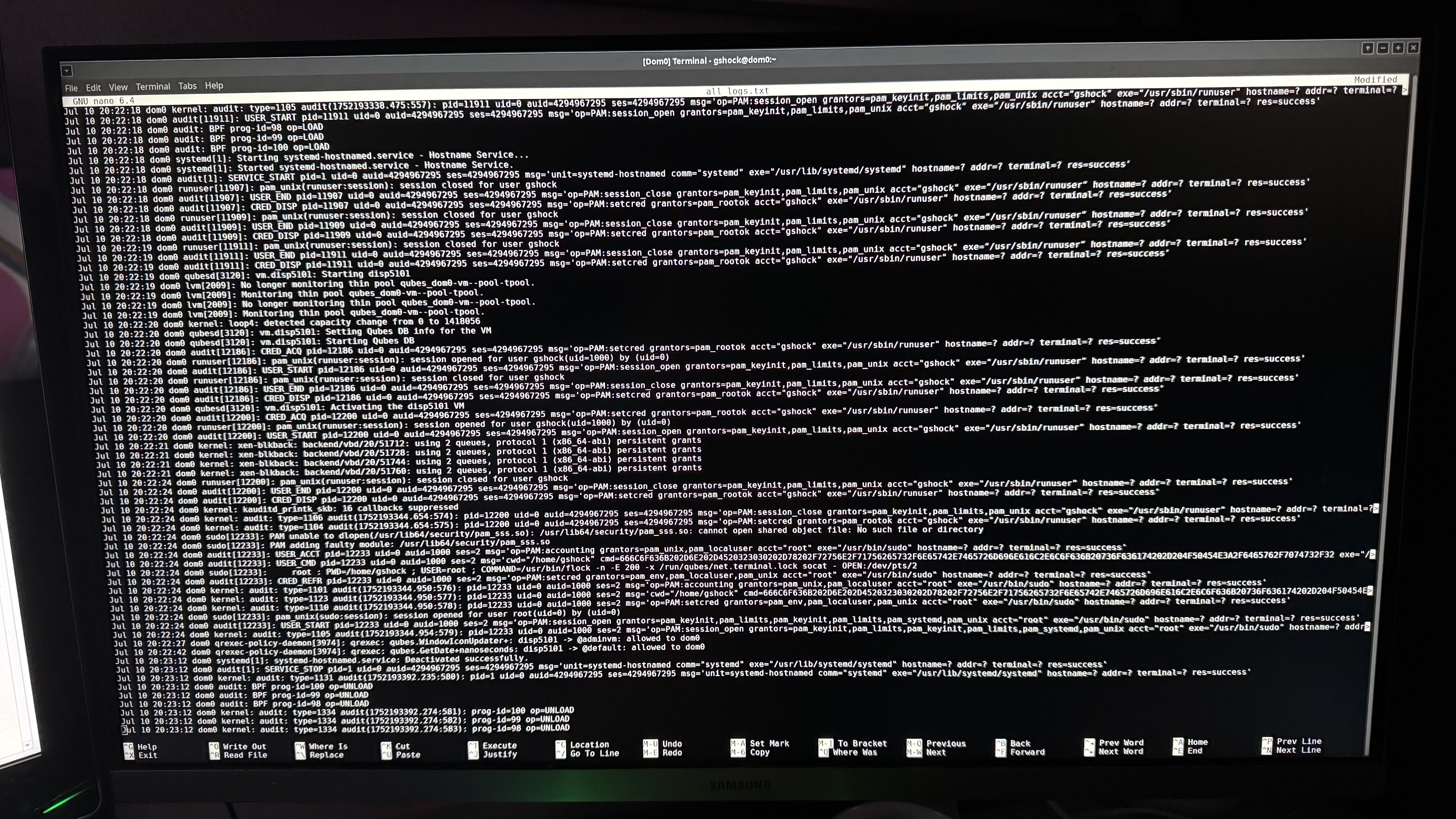

I found the breach last night. What are the IOC’s? Painful upload times, router firewall blocking attacks minutes after being reset. Then later in the day I notice a lack of privileges, a boom of unknown processes, cleaning of the logs, you know the classics.

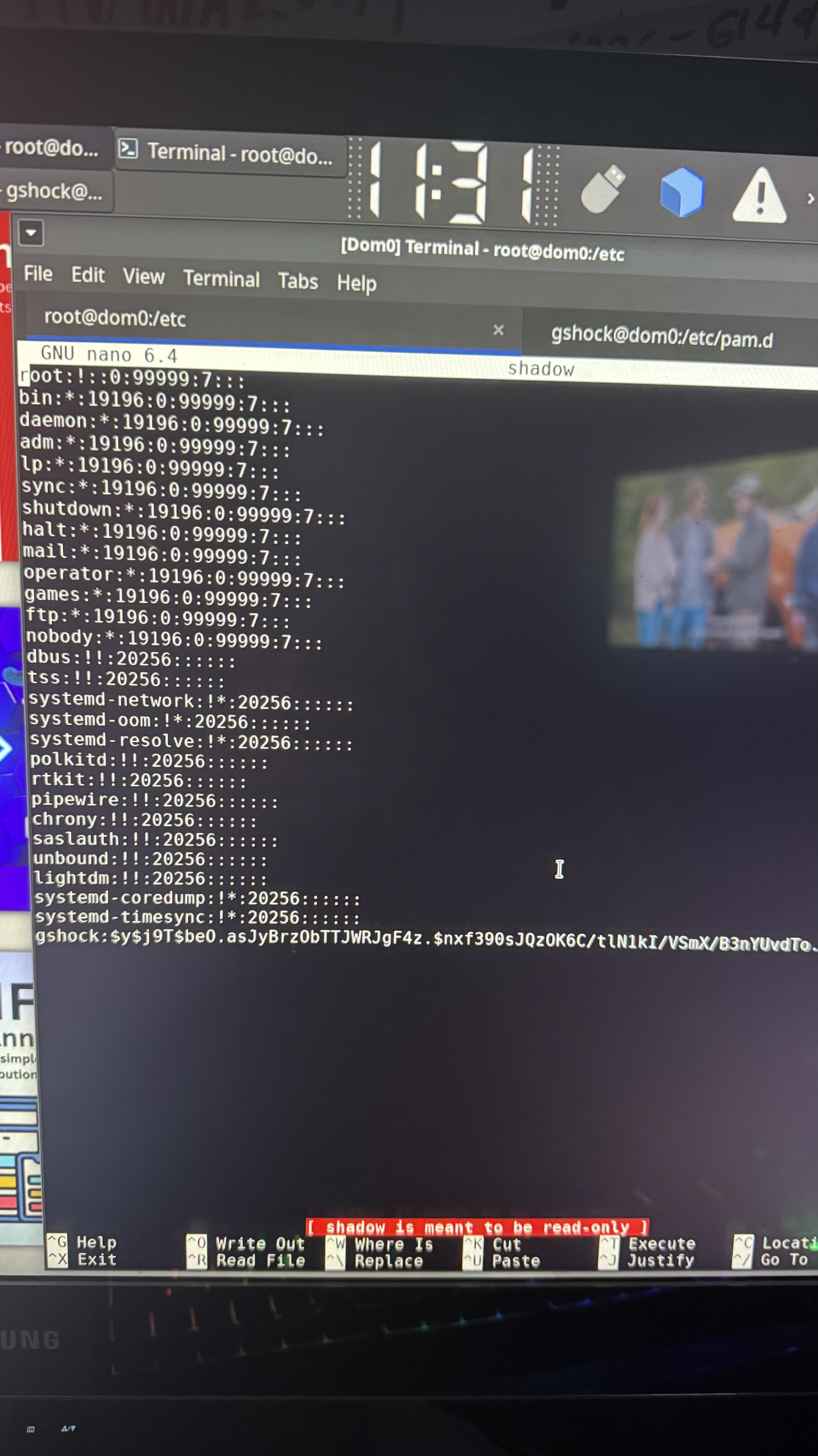

So in shadow, check out how he disabled the root user, also in the same photo how he took over the Gshock account and how he put the password right in the file. Neat. I don’t how he does it but he always uses PAM against me.

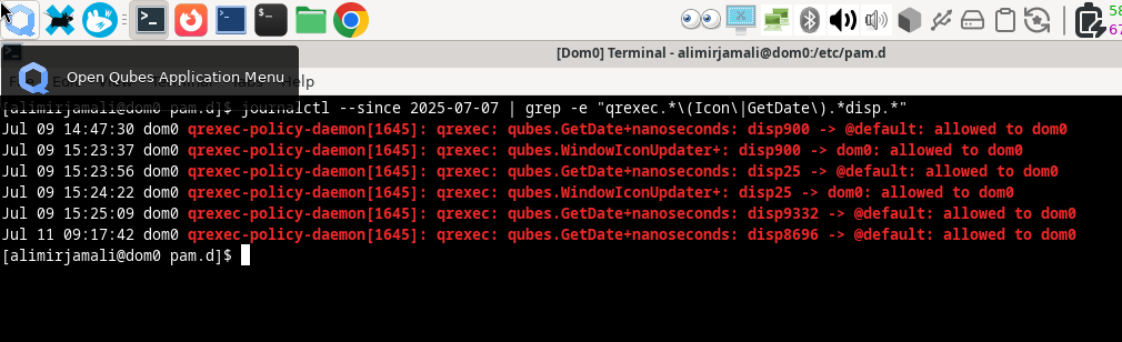

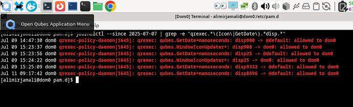

Ok so this one’s a little crazy. Towards the bottom he starts a DVM, Disp5101, and changes the policy over Dom0. There’s another photo where he changes the usb qube to change dom0.

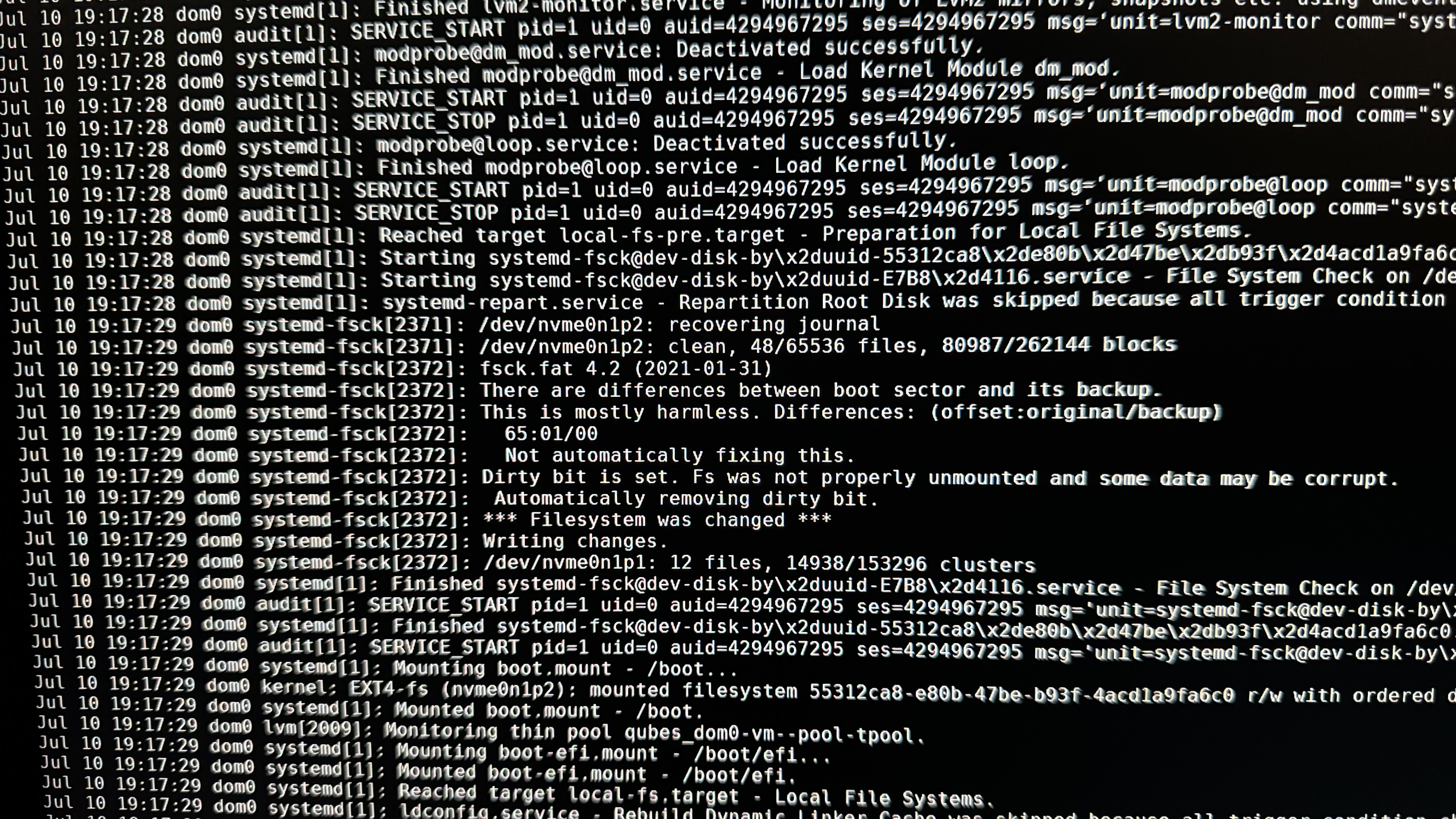

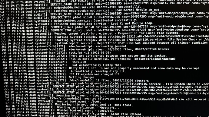

The message Repartition Root Disk was skipped because no trigger condition checks were met is because of systemd-repart.service. Which is a part of systemd and documented on Freedesktop website. Also on Archlinux Wiki. Or Debian as well as other places.
But the other messages could point to power-loss, tampering or bugs.

I think root having ! as a password is the default because you can’t log in as root directly, you need to use sudo.
Your user shock has a password set in /etc/shadow, seems fine to me except if it changed without interaction from you of course.

In /etc/shadow` the root user is disabled in a normal Qubes install -
this is not a sign of anything untoward.
I’m not sure what you mean by “put the password right in the file” - if
you mean that your plaintext password has been inserted in to
/etc/shadow this would be foolish - that user would be blocked
from logging in. But I’m at a loss to understand what you might mean.
Absent more details about the alleged takeover of your user account,
there’s nothing here.

So here, what messages are you referring to? Like the picture below?

Sorry, you wrote shock, I should’ve assumed gshock. When I try to make changes I’m no longer able to because I don’t have the privileges. I thought the shadow doc prove, but I guess not. I’ll show you more, maybe of the users in the groups.
Yeah but that’s not my password in plain text
one picture shows /etc/shadow where last user is gshock and there is a hash in the password field
That picture shows regular qubes.WindowIconUpdater and qubes.GetDate policy evaluation in the journalctl output (for a disposable).
@Cantwin : looks like you’re overreacting. Your system crashed somehow, and nvme1p2 (your LUKS) journal was recovered, while nvme1p1 (probably /boot) was not automatically fixed. The rest of the screenshots (/etc/shadow, the dom0 policies) are normal, as @alimirjamali pointed out.
