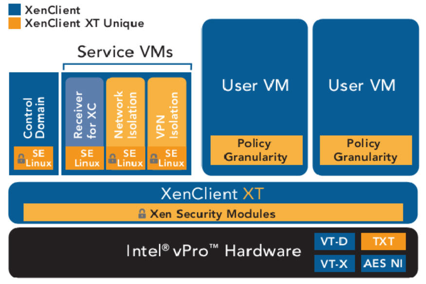

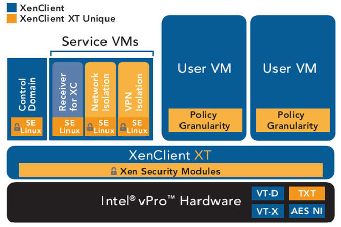

There’s even a comparison of SecureView with Qubes:
Multipurpose platform for Security Analysts - NTNU Open
Their architecture is quite similar, as both are based on Xen, but while SecureView is quite static to support multiple classification levels, Qubes is flexible enough to support everyday computer usage. Knowing Qubes, the structure of SecureView looks quite familiar:
In my opinion, the security of Qubes is better than that of SecureView, because it has such features like the template concept and disposable VMs, which are invaluable for work in unstructured environments like those that many Qubes users are working in.
From a European view, it is now doubtful if using SecureView would be a good idea, looking at the current erratic American politics … :grimacing:
