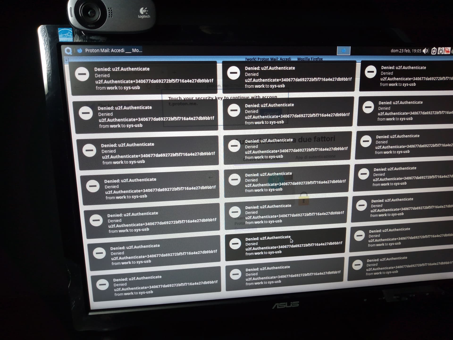

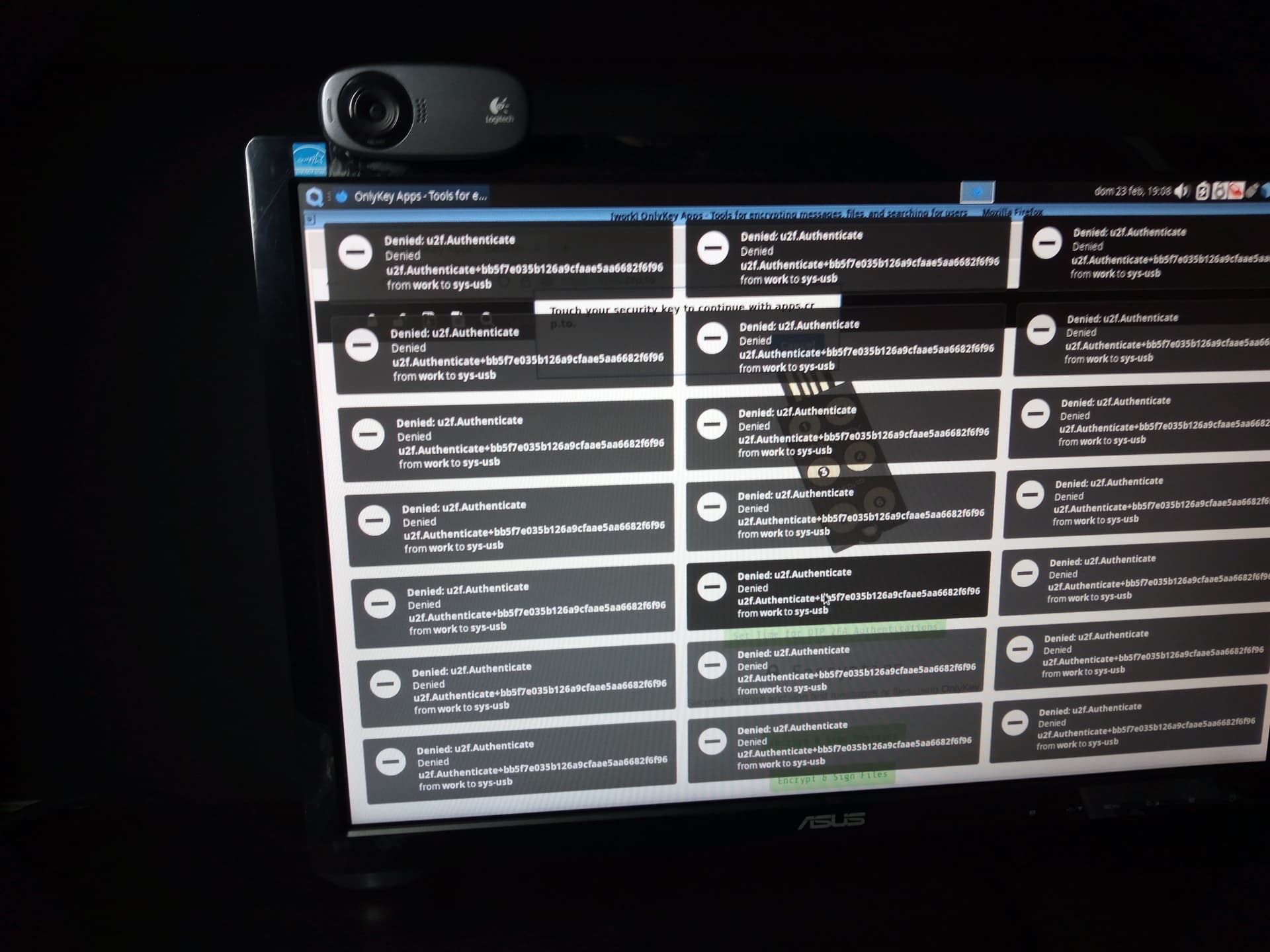

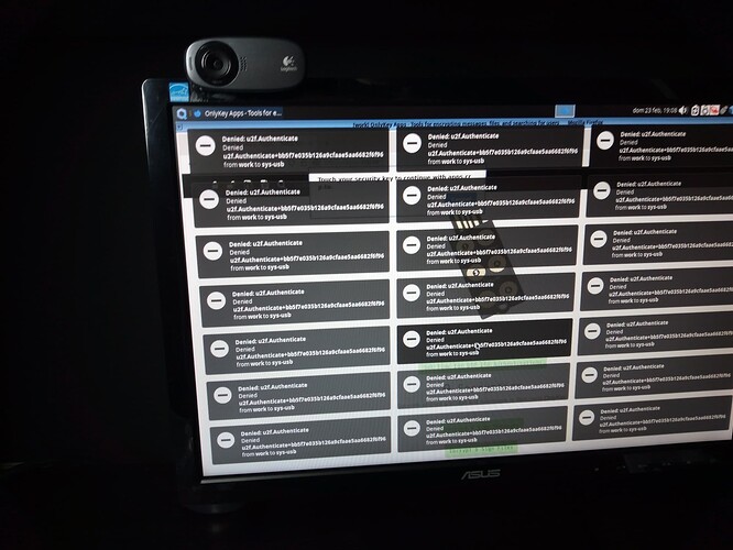

1)This is what happens when I try to synchronize the OnlyKey “stick” on the OnlyKey site to generate the OTP. I tried to synchronize the OnlyKey “stick” also with “sysUSB” (making the appropriate changes on the qube Manager…) and then generate the OTP on Firefox Browser of “work” appVM: the generated code was not correct and did not allow me to access one of my online accounts.

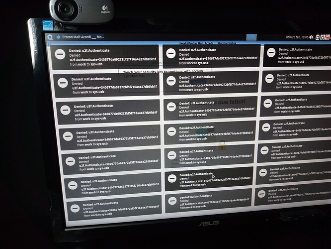

2)I tried to log in to my Protonmail account using FIDO2 authentication and this is what happens.
