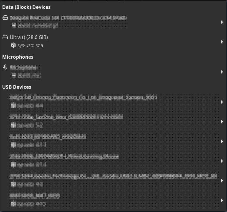

You need to write the ISO image to the USB drive by attaching the USB drive to the “Internet” AppVM using the Devices Widget or qvm-block:
Afterwards, you can use the dd command with the correct mount point to write the ISO to the USB drive, then you should be able to boot from it by modifying your boot options to prioritize booting from the USB drive first.
Oh, it’s so simple. I always connected USB sticks to the app in the selection window starting at the top with “Data (Block) Devices.” You have to use “USB Devices” further down. Because I don’t know what I’m doing…

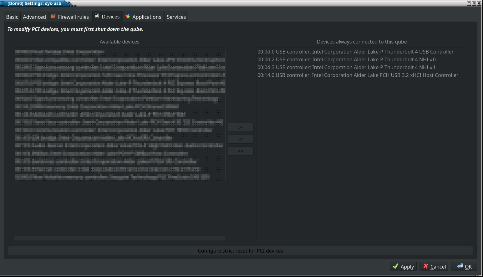

What? You cannot attach USB device in Devices tab in VM setting. You can attach whole USB controller to appVM but then you need first remove it from sys-usb so if you have only one controller (most cases on laptops/computers which have only one USB controller from CPU) you lose any USB connectivity (usb mouse and keyboard) in a system except to that one appVM.
If you attach from Data (Block) Devices in system tray then FMW won’t see it.
In order for Fedora Media Writer to see USB in appVM is attach it to appVM with qvm-usb for which there is no GUI, so you need to open dom0 terminal.

Ah, ok, my bad, didn’t see it.
It’s listed in tray devices icon, down below block devices in USB Devices.
Sorry.
It can be attached from GUI.

Using the mouse, insert the USB stick into the desired AppVM in Qubes Device Manager using the line below the heading USB Devices. It does not work with the entry under the heading Data (Block) Devices. Then, as described on the Internet, create an ISO disk using the terminal command dd… or, for Fedora, use Fedora Media Writer.
