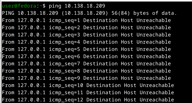

Can you ping 10.138.18.209 from that qube?

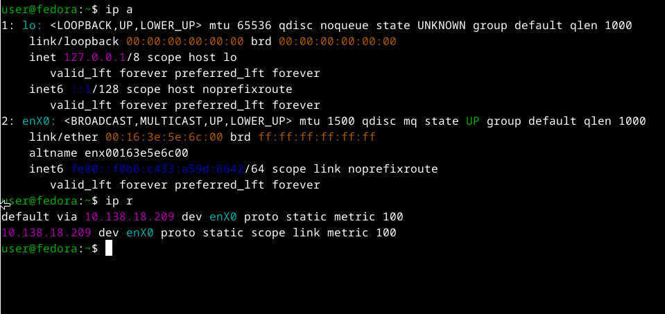

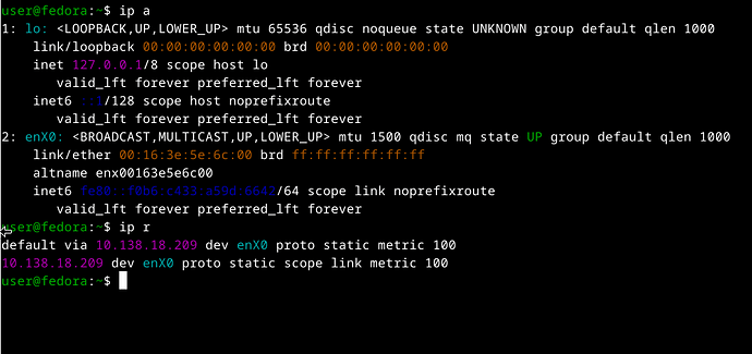

can you share the output of ip a and ip r?
Looks like something is wrong, ping is trying to use 127.0.0.1 :thinking:
The network device enX0 is not configured here
What do I need to do for the configuration?
What exactly should I do? The device is connected, and the connection settings are specified. I don’t quite understand what I need to do. Please help :pray:
