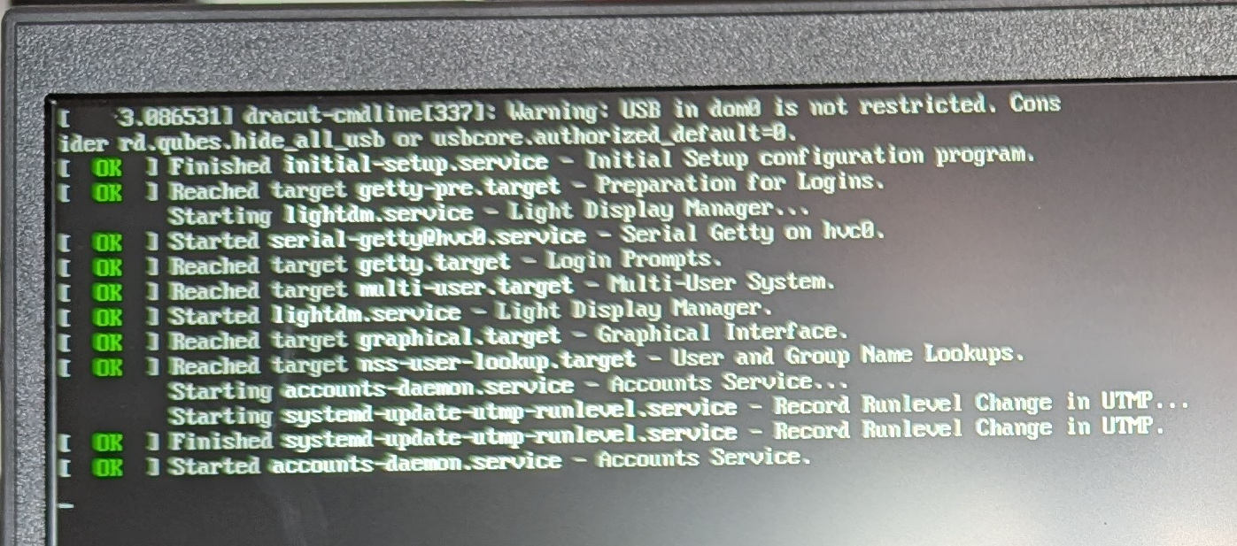

Installation completes successfully. But on the first run, I check the Qubes configuration options and during that configuration, the graphical installer seems to die and I get this on the vga console:
This screen stays stuck there until I reboot (by pressing ctrl-alt-del, powering off and on, or logging in on tty2 and issuing a sudo reboot).
Then, on the second boot, after entering the luks passphrase, the system doesn’t seem to finish booting up. The login manager never shows up. I can switch to tty2 and login there, but not to the gui.
In that first boot configuration menu I tried different setups: default options with debian as default template, default options, no configuration at all. No change: no login manager.
