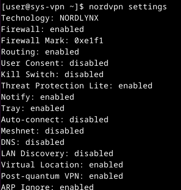

What nordvpn settings shows in DNS line? Should be disabled.

Here are my full Nordvpn settings:
Even though I did all the steps correctly, are you suggesting that I don’t follow steps 3, 4, and 5 and go back because they are messing things up? When I ping that ip nothing shows up as usual.
Please provide the content.
