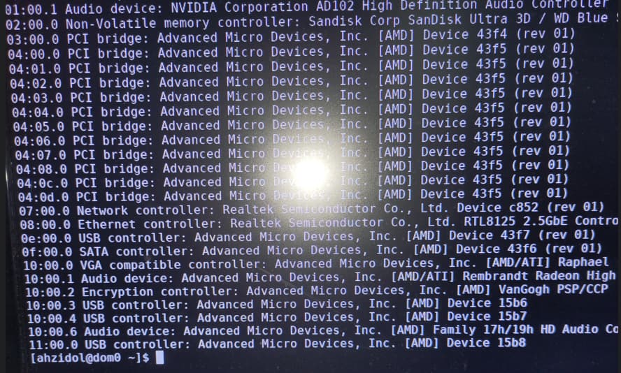

The Network controller can be detected when running ‘lspci’ in dom0:

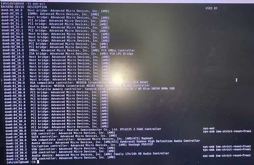

However, not when running ‘qvm-pci’:

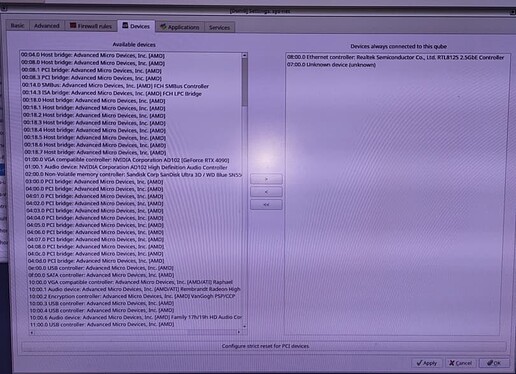

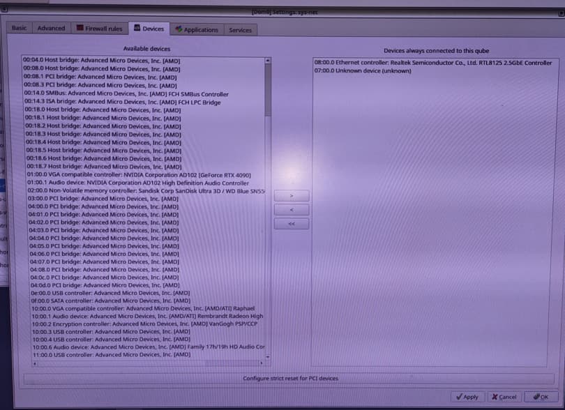

Here are the devices assigned to sys-net:
I tried simply removing the dom0:07 (Network Controller) from the sys-net Qube, however this made it disappear from the list entirely, and I reinstalled Qubes to get it to reappear.

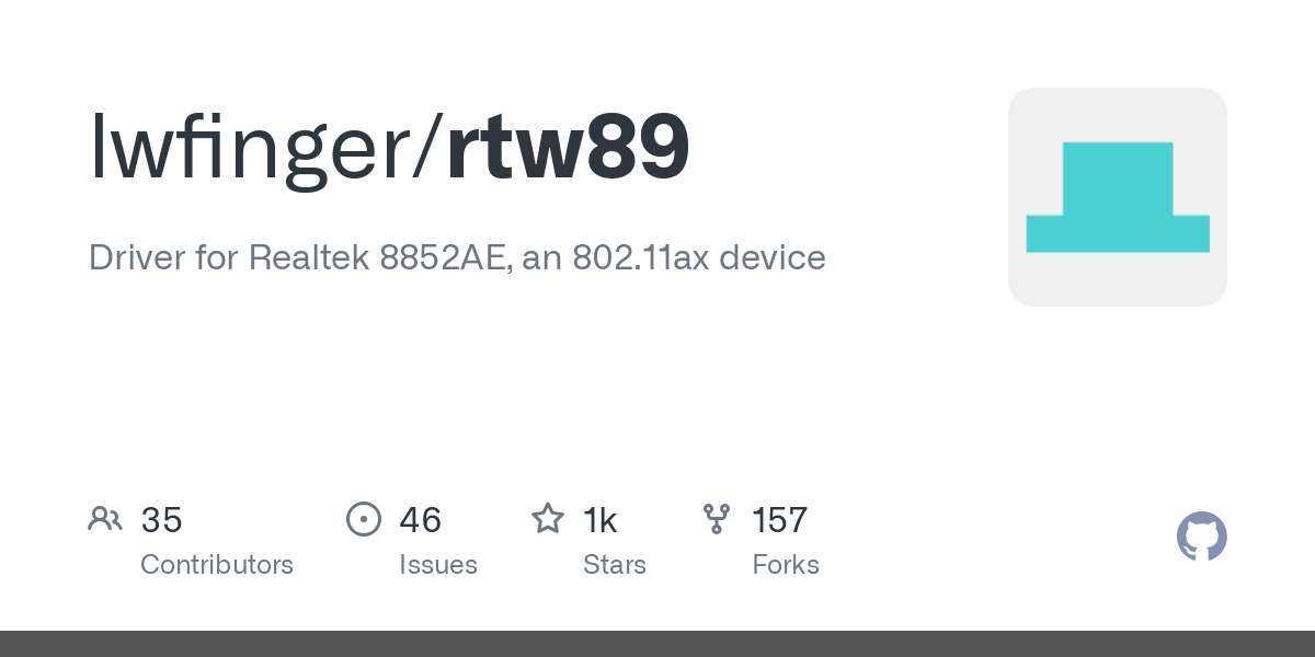

Just an update on this, I am having trouble even getting the Network Card to function on a new Debian 12 installation. Having researched it more it seems to be a whole saga.
https://forums.linuxmint.com/viewtopic.php?t=422471
https://bbs.archlinux.org/viewtopic.php?id=286109
I couldn’t pinpoint an exact reference for when the driver was fixed / supported in the linux kernel, various sources gave me different answers, however I assume the latest kernel Qubes uses doesn’t have it.
