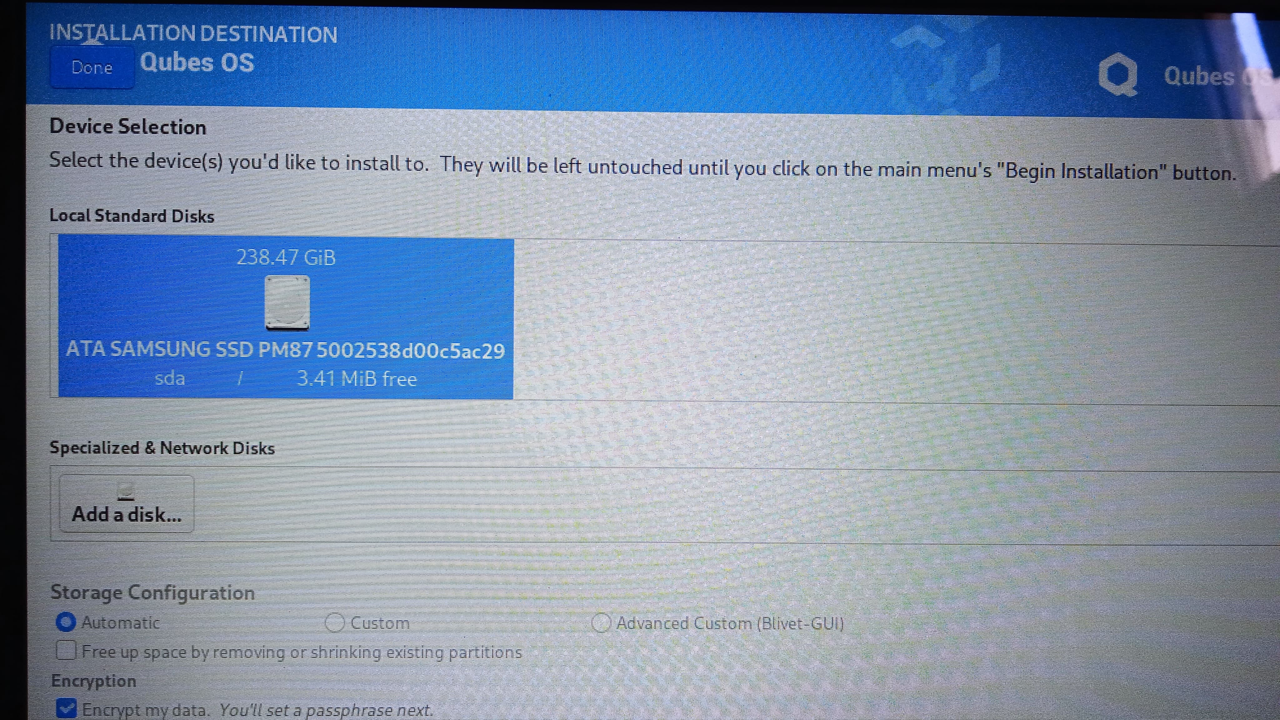

guys i need your help please when i reach the installation process of qubes os, the os can’t detect the second usb of installation it only shows the ssd disk. what’s wrong and how to fix please? btw :

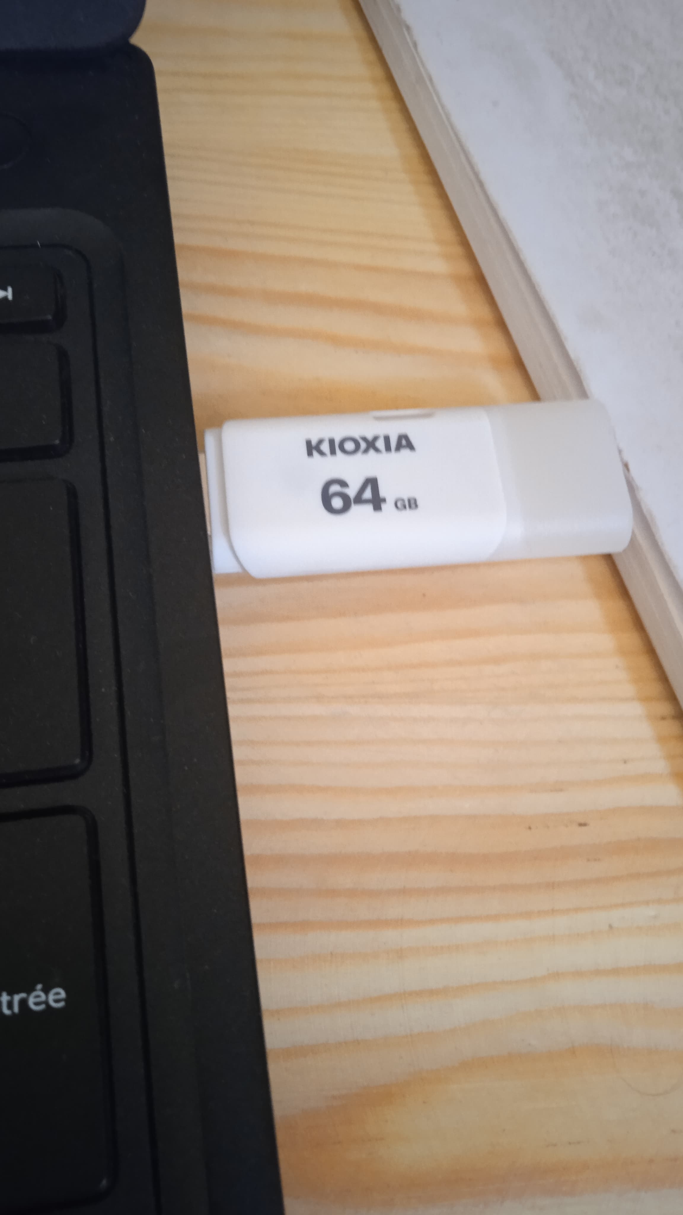

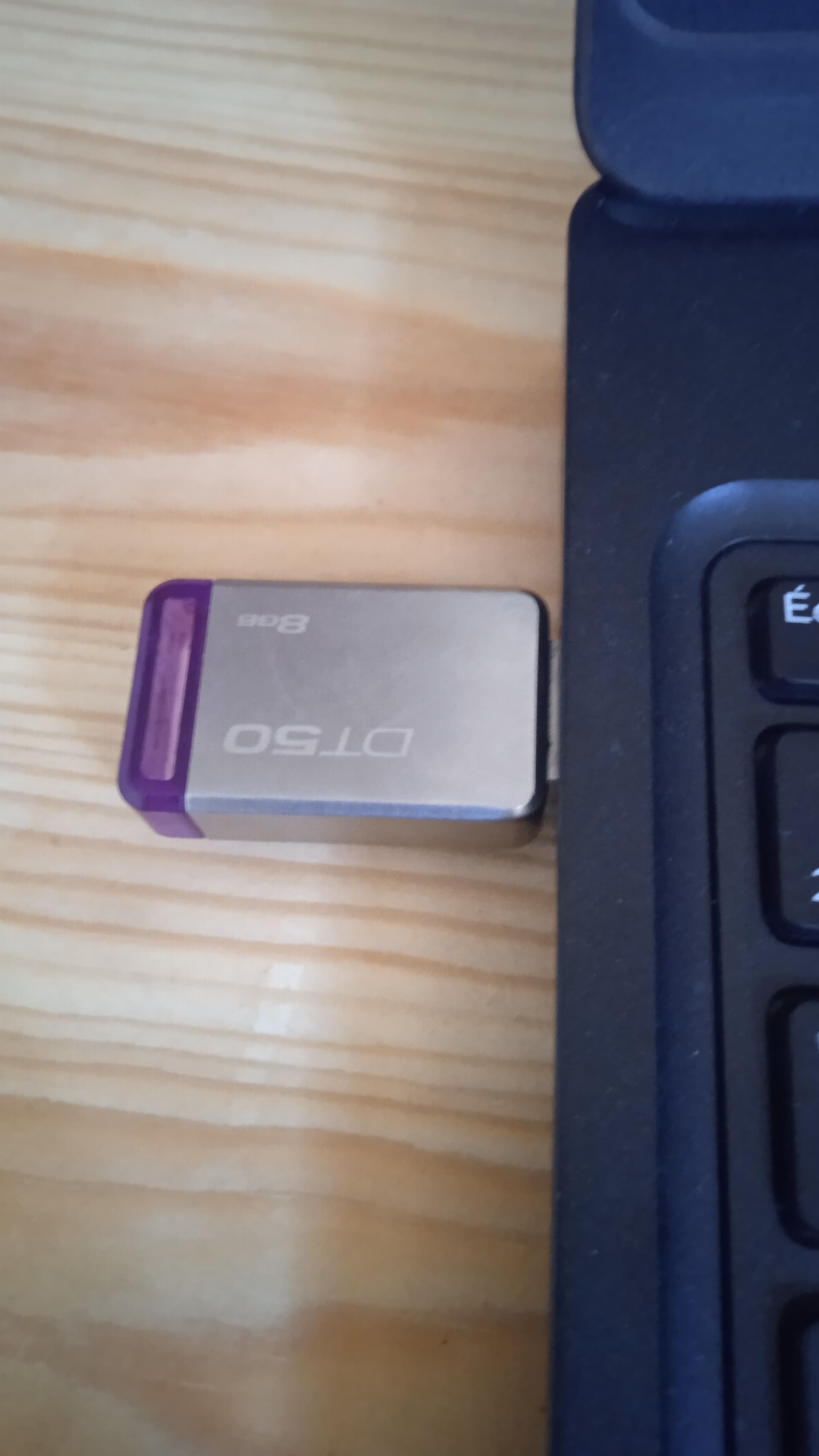

Yes… i have 2 usb one that i boot from(kingston 8gb) and the other one is for installation ( kioxia 64gb)

You can try clicking on “Refresh…” at the bottom right of the Installation Destination screen, maybe you’ll see your disk after this:
What to do bro ![]()
