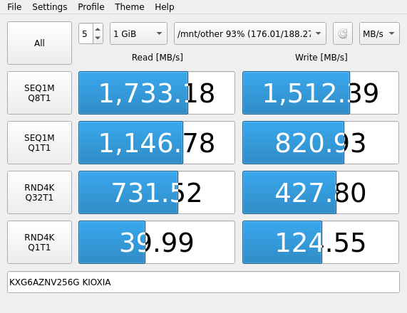

I demonstrate the real speed of the Nvme on my other computer using the KDiskMark utility:

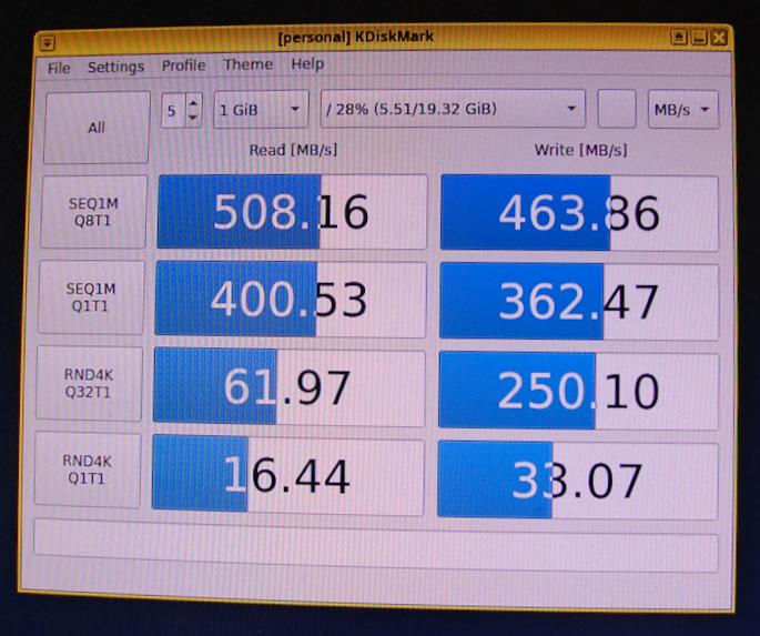

Therefore, I measured the speed in Personal Dom
Speed SSD PATRIOT 128GB on Personal Dom :
What do you think about these different speeds?
Under these conditions, Qubes takes 19 seconds to load and Firefox takes 11 seconds.
That seems pretty long to me ![]()

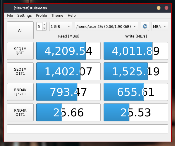

Here is the KDisk stats from my drive, PCIe 5.0 x4
