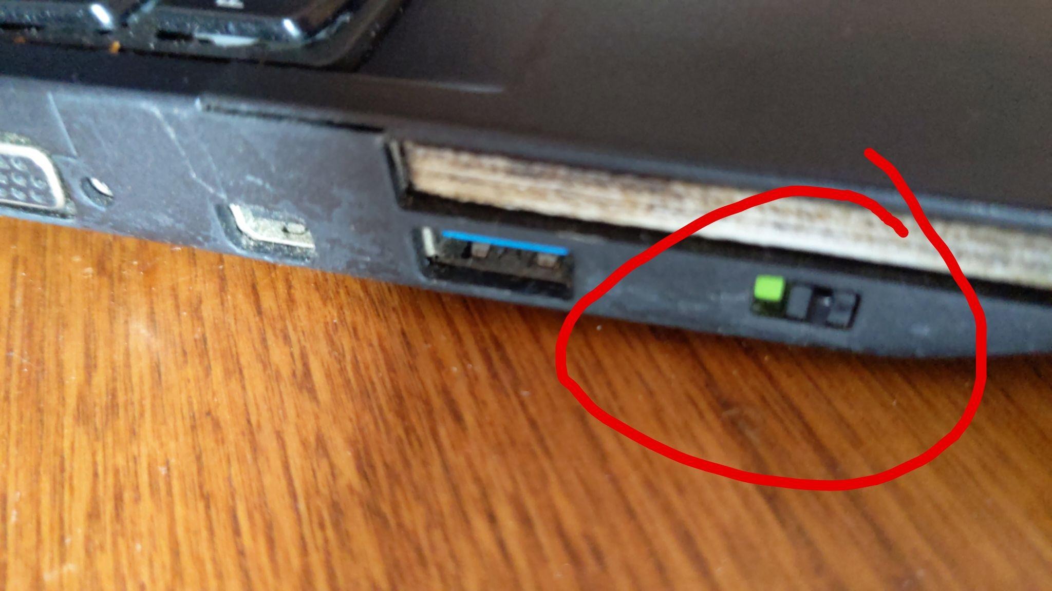

- What if… the wifi slider was simply slide to off?

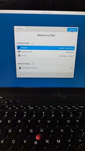

Boot into verified Tails from Options → Boot Options → Boot from USB
Cutomize Tails by adding additional functionality (+)
Add Administrative password to be able to do changes on the system
Start Tails. Here you can also connect to network to see if any hardware faults are present
Launch a Administrative Terminal (Root Terminal)

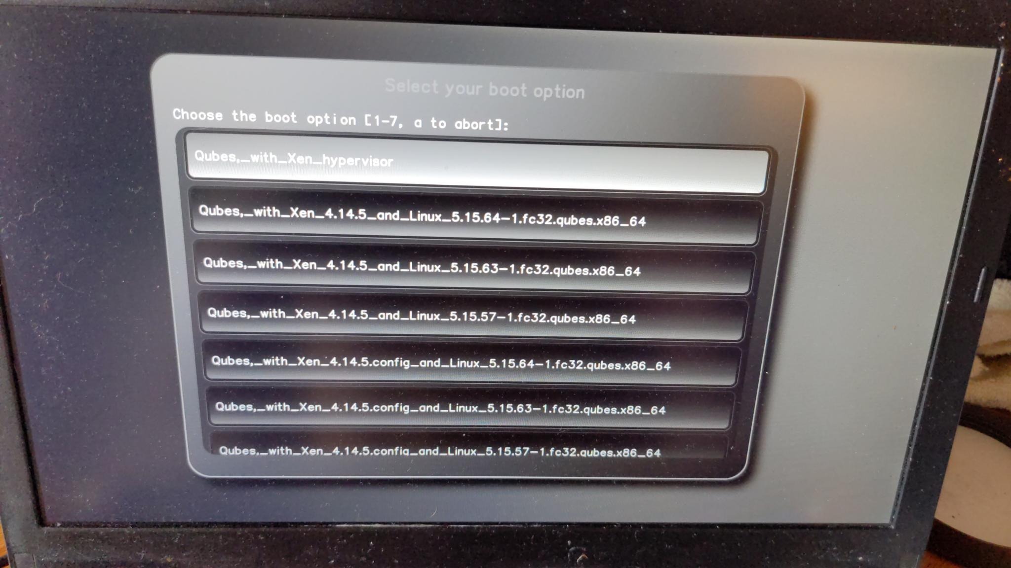

Launching default boot option will have Heads complain. We won’t update checksums now. Say No!!!
We will instead boot in unsafe mode the first option we modified
We can see if we check carefully that our added
qubes.skip_autostartis passed to Qubes
We see that no qubes are automatically started
We fix things and make sure that things are as expected. We can then start a normal workflow here. We are under Qubes, we just prevented any qubes from starting automatically. We can start things manually here, which is the goal of the operation.
We Apply, save and reboot, and boot again with second boot option (unmodified)
We see our option not being passed to kernel

We make sure the wifi slider is in ON state
