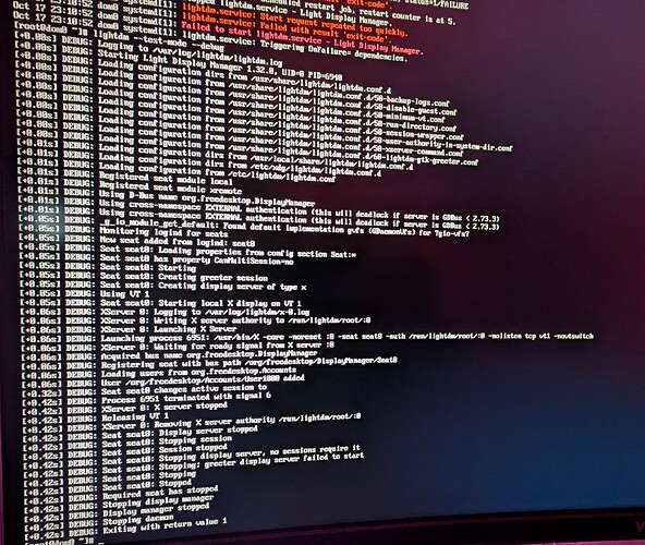

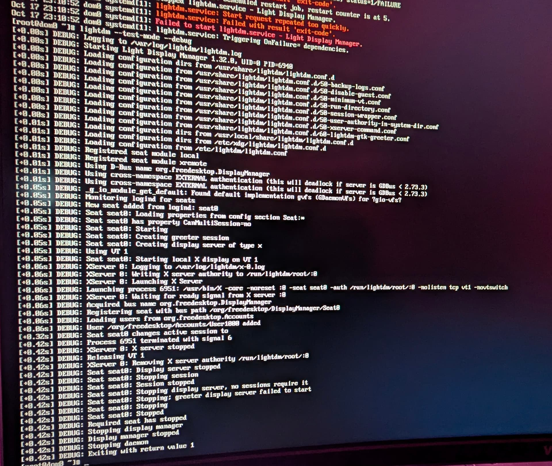

On suggestion from another thread, i tried running lightdm --test-mode --debug. It shows that X is failing to start:

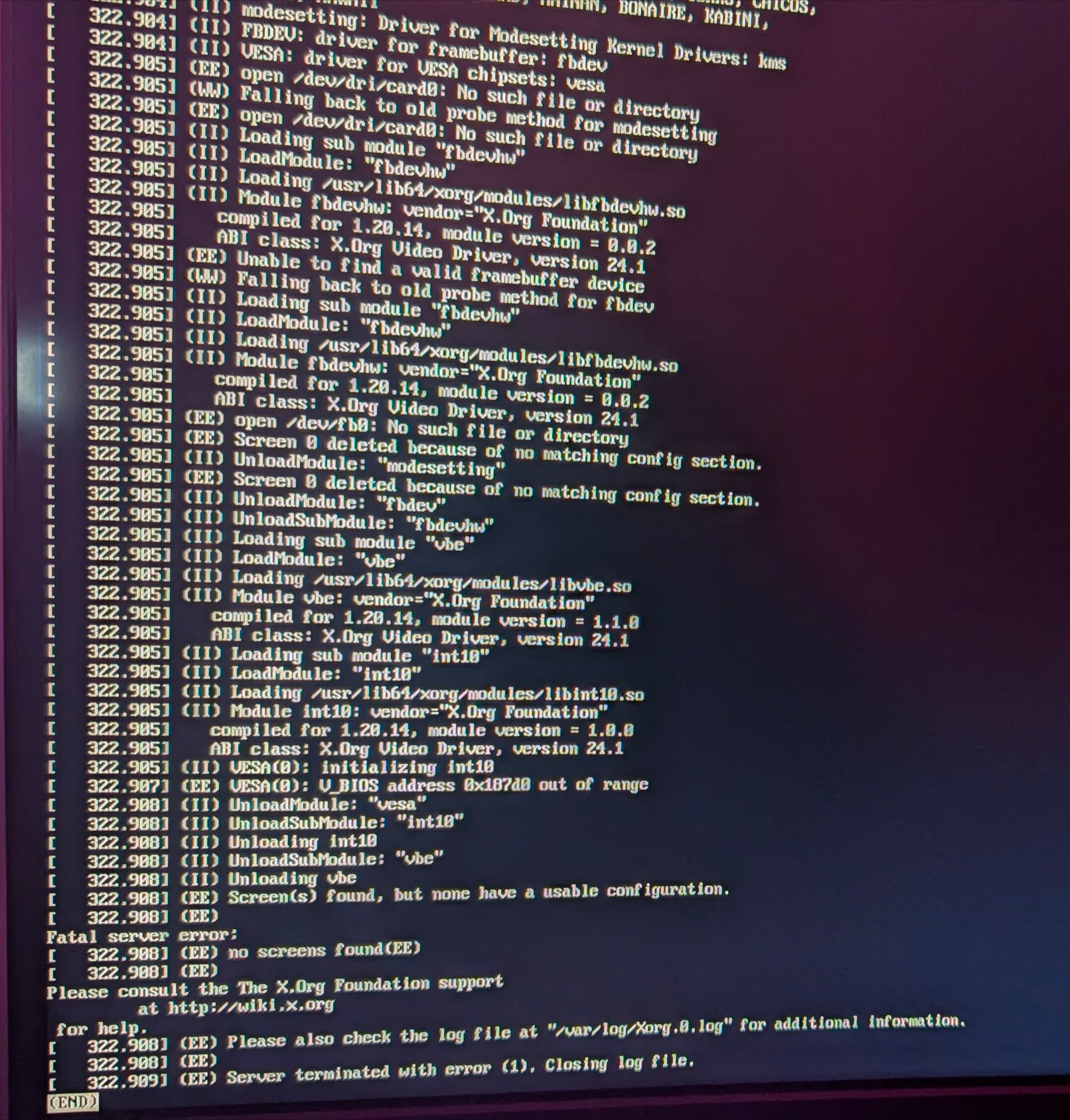

So i checked /var/log/Xorg.0.log and it seems like the error is happening because /dev/dri/card0 is missing. EDIT: actually idk what the real cause is.

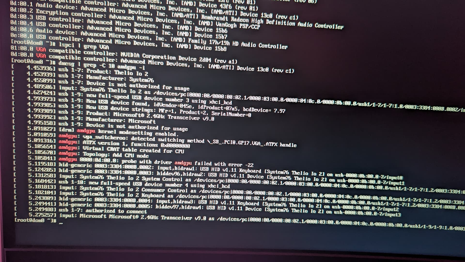

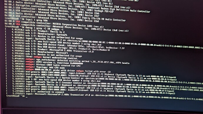

Search for amdgpu in the dmesg output to see if there are any errors.
It’s an AMD Ryzen 9 9950X, and according to this page the iGPU is a Radeon 2CU 2200MHz RDNA 2.
I did find some dmesg logs pertaining to this device:
Nothing for nvidia or nouveau.
