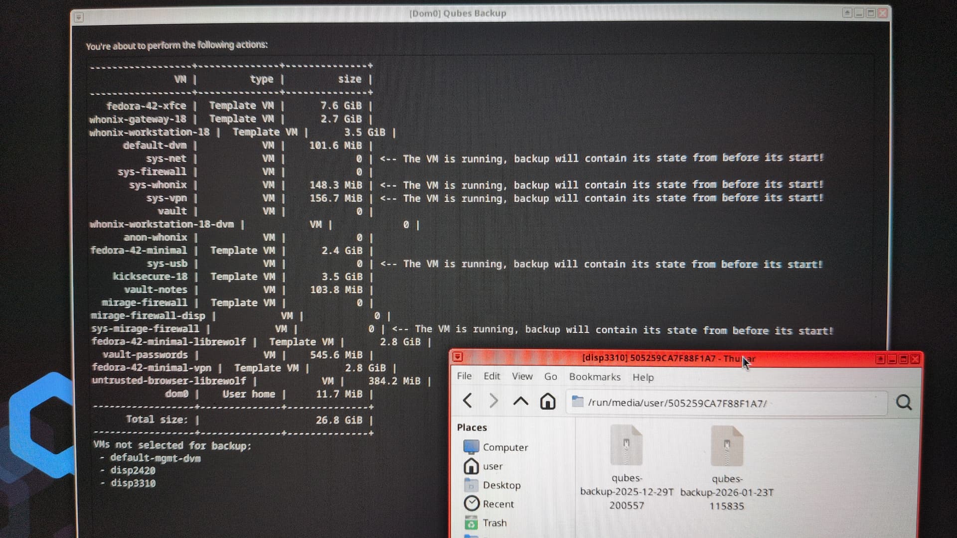

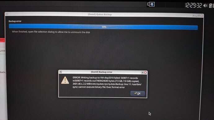

Lately, I’ve been trying to backup my Qubes but, every time, at the end of the process, I keep getting this exec format error.
I’ve recreated the error and taken screenshots along the way.

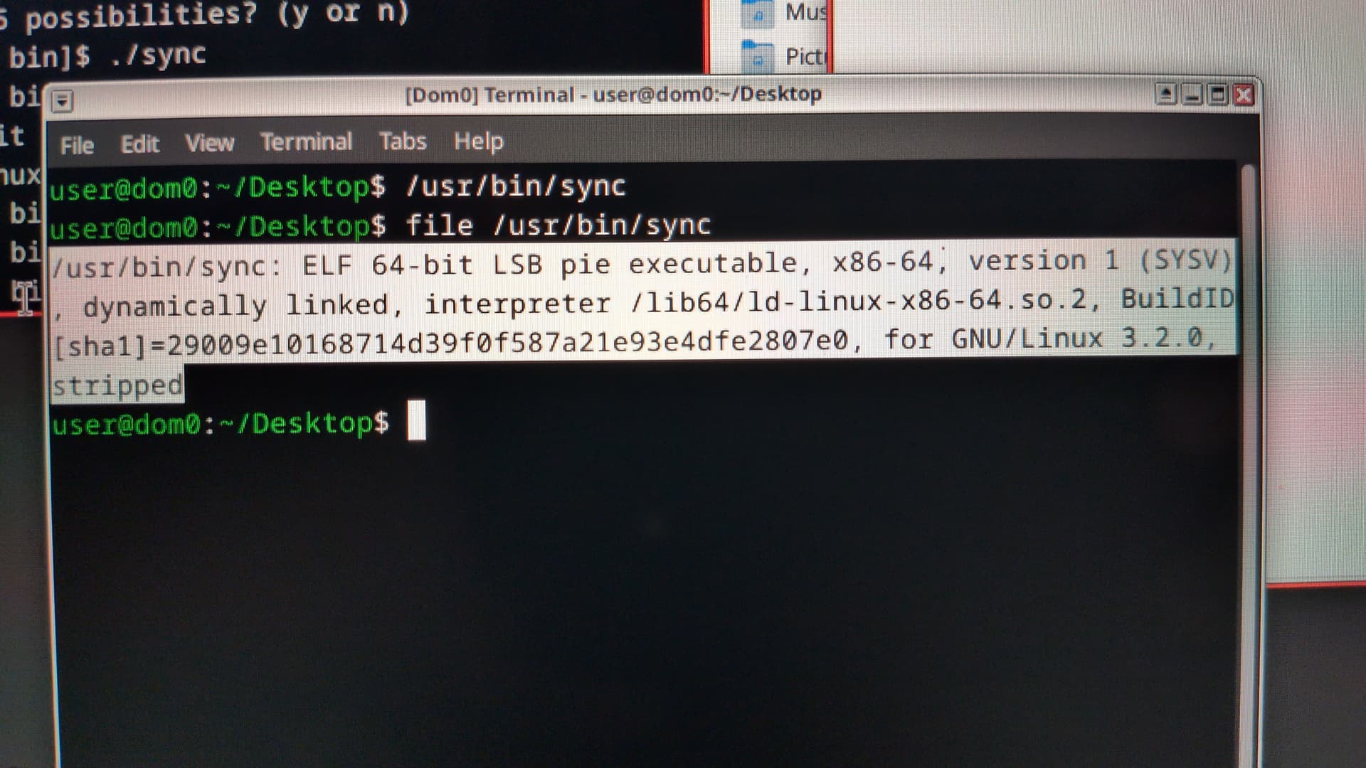

I don’t know how to copy and paste anything from dom0 so here’s a screenshot instead
Weird, weird, weird, I’m not sure what could be causing the error in the OP, then.

Do you also see this “Exec format error” message printed if you run
$ qvm-run --service --pass-io disp1234 qubes.Backup <<</tmp
in a dom0 terminal?
