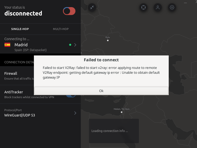

Can someone explain me why i have this message error when i try to use v2ray option from the ivpn app ?
Do you have any net qube associated with this qube?
Thank you for your help !
The qube is associated with mirage-firewall and I tried to install GitHub - v2ray/v2ray-core: A platform for building proxies to bypass network restrictions. in the system but this didn’t work. I don’t know what to do more…
Could it be possible for you you try with a simple qube with sys-firewall as a net qube? That would allow to figure if there is an issue with ivpn or the layers added with mirage-firewall and v2ray

Hello, i find the problem ! I’ve installed ivpn package and net-tools package for testing in the minimal-template sys-net. Then i connect to my account and i tried the v2ray option and it’s working great !
IVPN obfuscation is working only if the user install the IVPN package in the template of sys net. I think IVPN need to detect the network card in the system for obfuscation…
But i don’t understand if this issue is coming from IVPN or Qubes ? This is a little bit annoying because i prefer to install the vpn package in the minimal-web-template
