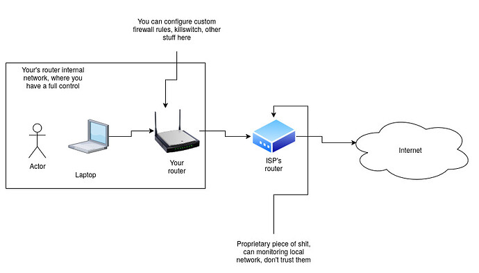

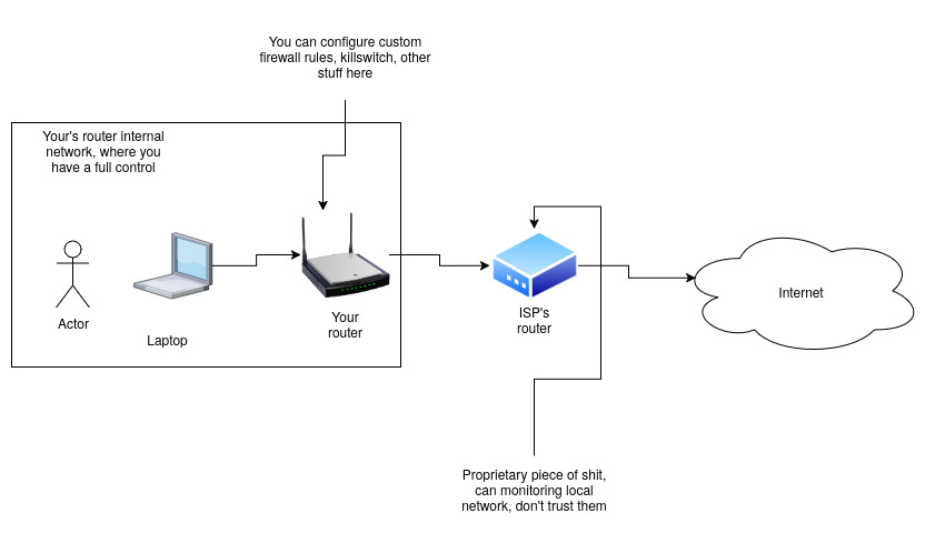

How i understand, the main idea looks like that. Your ISP probably want to monitoring your local network and send data about your devices (maybe something more, for example device uptime, MAC addresses, network activity, local services) on their servers. Don’t trust them. So you can use your custom router before ISP’s router for controlling your network. Most local services don’t use encryption for communications, in this case ISP’s router can sniff netflow. Sorry for my bad English.
Just for fun you can install the extra router before ISP’s router and sniff ISP’s router network activity, for predict what the ISP’s router is really doing. Or maybe reverse engineering their software.
