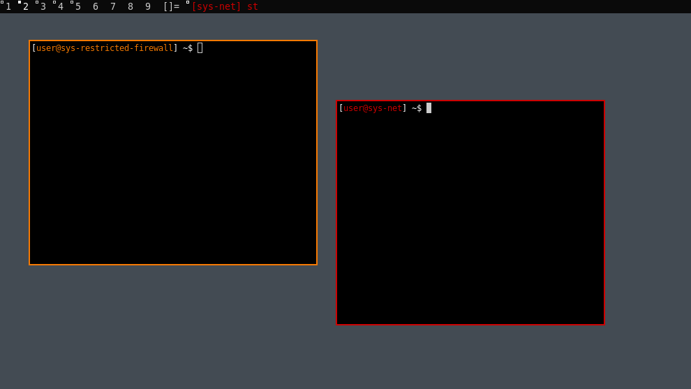

I appreciate the help. I managed to create something similar using qrexec that, although a little slow, works perfectly for my use case.
Is this setting the terminal color based on the qube color? If so, awesome idea. I suggest writing to qubesdb and then reading via qubesdb-read in the qube which is practically instant.
