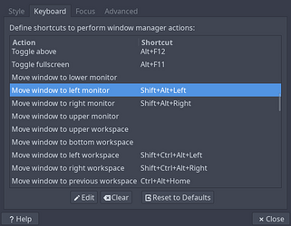

There is no way to move windows between monitors until Xfce Xfce4 4.17.2 (2022 Dec)
But you could move windows between workspaces with default xfce4 window manager.

KDE has long had shortcuts for moving windows to next screen.
