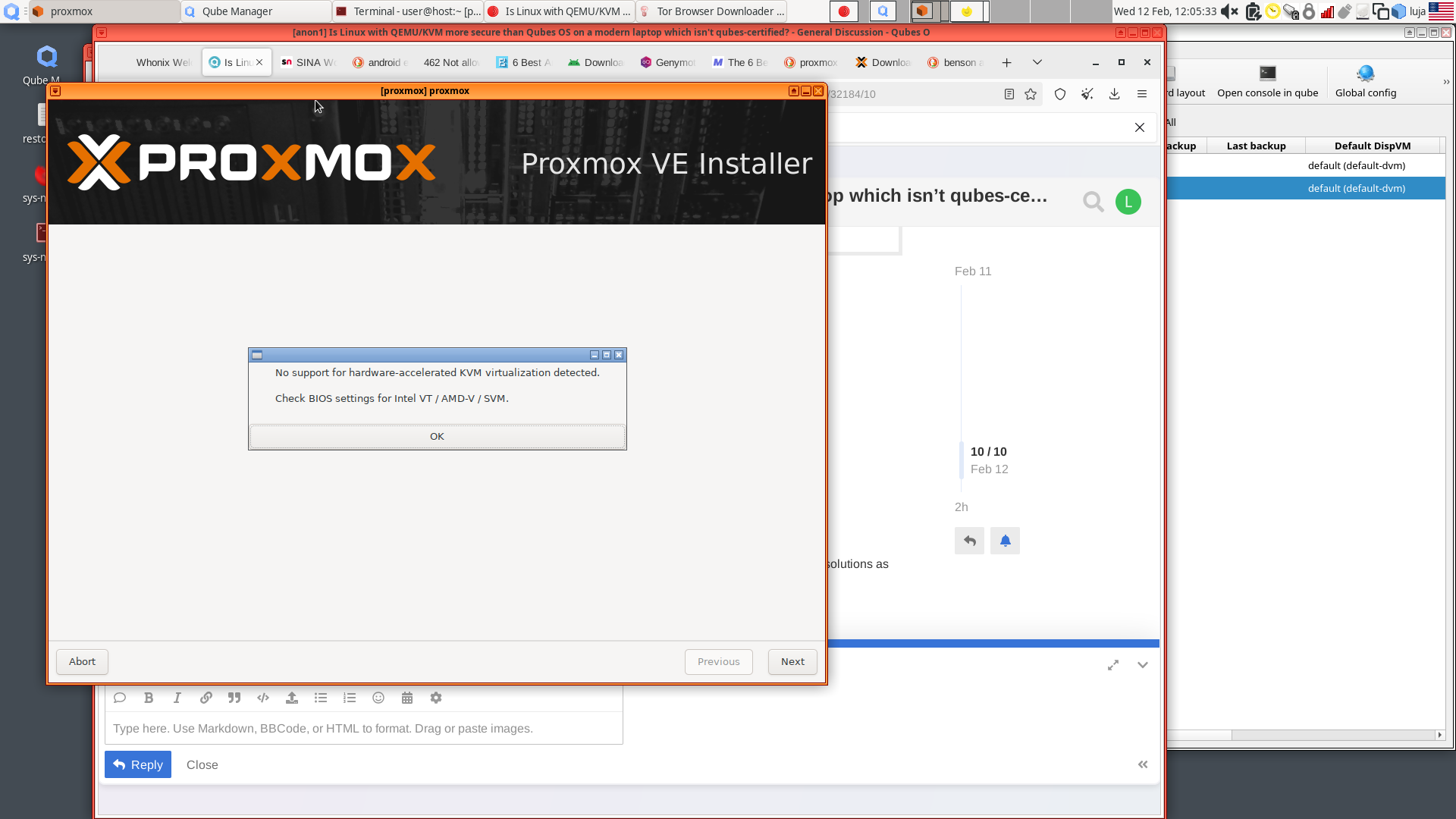

Update:
I tested it in graphic install mode as stand alone VM as one would install windows 8.1 (works, is not worth a mention) and got a popup reading:
“No support for hardware accelerated KVM detected”
“Check BIOS settings for Intel VT / AMD-V / SVM”
So you can say thank you Mr. XEN.
But XEN says it is able to do nested…

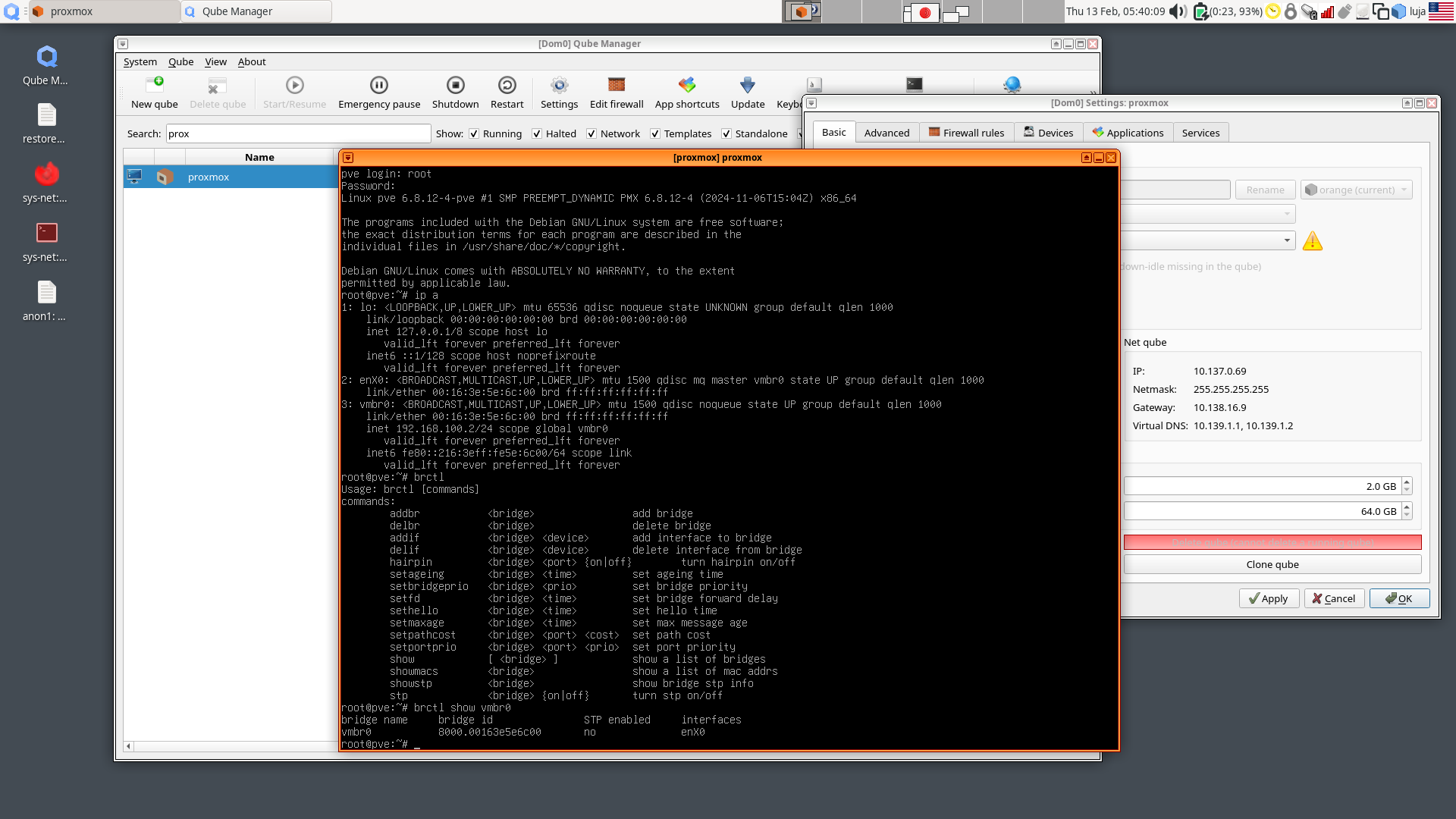

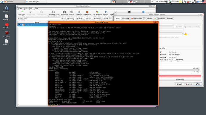

BTW: top left in the screenshot> a browser short-cut for sys-net is nice for using wifi captive portals.
How to use the internal Qubes-OS net?
Is there comprehensive documentation about it. Do we have softswitch or some other tool to manage the internal net?
A virtual VLAN-switch with ports to assign to different VM-guests would be nice. In the style of the qubes-manager. A DHCP server to be assignable to VLANs and Ports and with some configurablility would also be nice.
I can not use the proxmox web interface and tried 10.x and 192.x net.
Also I checked “provides network to others” in the qubes-manager.
dhclient enX0 does not give proxmox a dhcp lease.
I guess that I need to dig deeply into the net internals of Qubes and have an iptables orgy, right?
