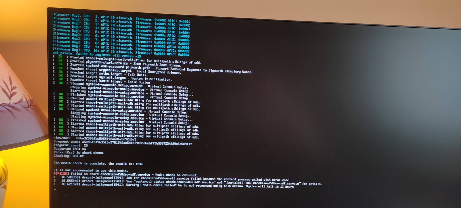

Hi. Is it possible to go further or should I give up?

Can (are you willing?) to share a bit about your situation?
From the image alone, I’m tempted to reply “probably” to the question … :wink:

Never mind. I know what’s going on now. I thought I had read the installation guide carefully, but somehow I missed the part that after making usb with Rufus, the verification would not work.
Before flash (dd) this media you check hashes and signature?
After flash (dd) you double check hashes?
I recorded it again, this time via dd, and it’s fine.

Could you mark the message about writing with dd as the solution? – just to help the next one landing on this topic … :slight_smile:
