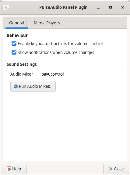

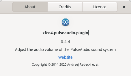

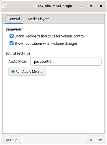

I don’t have that! xfce4-pulseaudio-plugin ver. 0.4.4 on R4.2.4 (up to date, installed as 4.2.1)
Edit: I only have two check-boxes, “Enable keyboard shortcuts…” and “Show notifications when volume changes”. And no sys-audio either.
The plugin release notes says that the indicator should be available on 0.4.4:
It might not be exactly 100% like the screenshots on this page, but should be available somewhere:
https://docs.xfce.org/panel-plugins/xfce4-pulseaudio-plugin/start
I get a different Settings Menu… will investigate why.
Later EDIT: no idea why. Maybe some later fixes were backported to Fedora? Versions immediately after 0.4.4 seem to try various fixes for a “flickering mic icon” introduced in 0.4.4.
