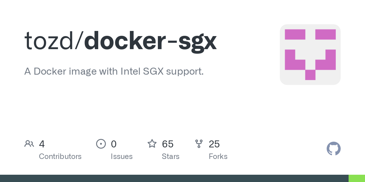

@ppc @brendanhoar @yann, I have read that the SGX actively supports the docker. Is there a way where I can install the docker on DOM0, and then run the VMs inside the docker? or if not, then install docker in the VMs, and run critical applications in the docker, with the SGX enabled? Like Email, financials, and administrative applications?
These are some links i found useful:
https://gramine.readthedocs.io/projects/gsc/en/latest/
yes, thought it not recommend
you can, but i guess you would not benefit from sgx (as it might require some kind of “passthrough” which is impossible for you since xen don’t support it)
