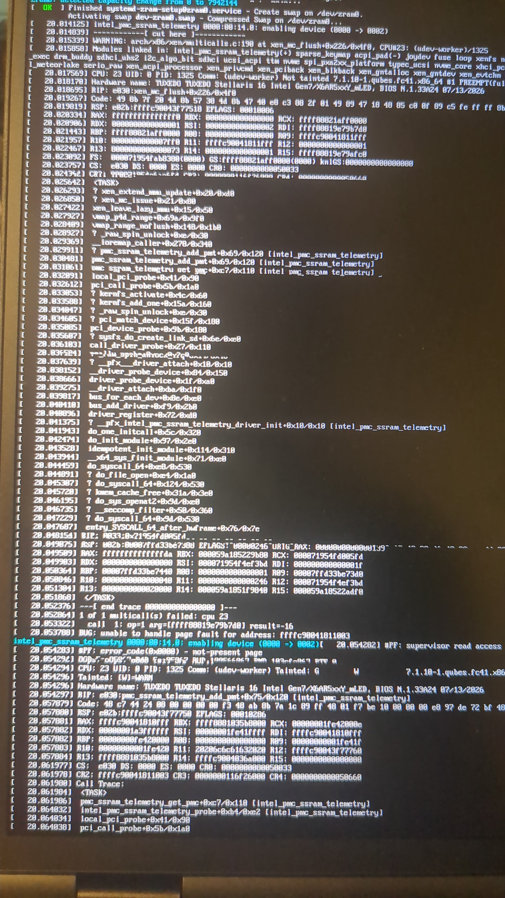

Hi,
first ever Qubes forum post.
I recently got my hands on a new laptop with an Intel Core Ultra 275HX. This (according to Intel documentation) has S3 sleep support. This support relies on the intel_pmc_ssram_telemetry driver which was recently moved out of intel_pmc_core. Without the telemetry driver, core won’t load and i am unable to suspend correctly.
Upon booting with i am greeted with a pretty much invisible error. Sometimes i catch it in the debug messages, other times the screen goes blank right before.
If i understand correctly, the telemetry driver tries to access some page in memory, which does not exist, causing xen to try to update the mappings from the mmu. I am not sure what exactly is responsible for the panic at this point.
All i know is that i need to blacklist the intel_pmc_ssram_telemetry driver for my system to boot correctly.
This issue does exist on the stable, devel and latest kernel of qubes and it does not exist on a simple fedora installation with the same kernel versions.
So I am pretty sure it is a xen related issue. I have yet to find any other references to this issue except people saying to just disable that module which sadly is not a workable solution for me.
Any help or ideas would be great because i am slowly running out of things to try.
The failing boot was done using the default qubes and xen parameters and loglevel=8.
The rest of this hardware is great and i would love to get this fixed but i could not find anything useful regarding this problem anywhere online.

I’ve gotten the kernel log from journalctl and this is the relevant stacktrace:
Aug 30 22:59:46 dom0 kernel: intel_pmc_ssram_telemetry 0000:00:14.0: enabling device (0000 -> 0002)
Aug 30 22:59:46 dom0 kernel: ------------[ cut here ]------------
Aug 30 22:59:46 dom0 kernel: WARNING: CPU: 11 PID: 1332 at arch/x86/xen/multicalls.c:190 xen_mc_flush+0x21e/0x510
Aug 30 22:59:46 dom0 kernel: Modules linked in: intel_pmc_ssram_telemetry(+) fjes(+) sparse_keymap acpi_pad(-) joydev loop fuse xenfs nfnetlink zram lz4hc_compress lz4_compress dm_thin_pool dm_persistent_data dm_bio_prison dm_crypt xe drm_suballoc_helper drm_gpusvm_helper nouveau mxm_wmi drm_ttm_helper i915 gpu_sched drm_gpuvm drm_exec drm_buddy nvme i2c_algo_bit sdhci_pci ttm ucsi_acpi sdhci_uhs2 nvme_core typec_ucsi spi_pxa2xx_platform nvme_keyring sdhci drm_display_helper typec dw_dmac nvme_auth hid_multitouch xhci_pci cqhci polyval_clmulni ghash_clmulni_intel spi_pxa2xx_core hkdf mmc_core xhci_hcd intel_vsec intel_vpu thunderbolt i2c_hid_acpi cec video i2c_hid wmi pinctrl_meteorlake pinctrl_meteorpoint serio_raw xen_acpi_processor xen_privcmd xen_pciback xen_blkback xen_gntalloc xen_gntdev xen_evtchn scsi_dh_rdac scsi_dh_emc scsi_dh_alua uinput i2c_dev
Aug 30 22:59:46 dom0 kernel: CPU: 11 UID: 0 PID: 1332 Comm: (udev-worker) Not tainted 6.18.44-1.qubes.fc41.x86_64 #1 PREEMPT(full)
Aug 30 22:59:46 dom0 kernel: Hardware name: TUXEDO TUXEDO Stellaris 16 Intel Gen7/X6AR5xxY_mLED, BIOS N.1.33A24 07/13/2026
Aug 30 22:59:46 dom0 kernel: RIP: e030:xen_mc_flush+0x21e/0x510
Aug 30 22:59:46 dom0 kernel: Code: 49 8b 7f 20 4d 8b 57 38 4d 8b 47 40 e8 7b 33 21 01 49 89 47 18 48 85 c0 0f 89 cd fe ff ff 8b 95 00 88 4b 83 41 be 01 00 00 00 <0f> 0b 65 8b 0d bd 20 fc 02 44 89 f6 48 c7 c7 50 6e fe 81 e8 9a e1
Aug 30 22:59:46 dom0 kernel: RSP: e02b:ffffc90043e3f4a0 EFLAGS: 00010086
Aug 30 22:59:46 dom0 kernel: RAX: fffffffffffffff0 RBX: 0000000000000000 RCX: ffff88821f0e2000
Aug 30 22:59:46 dom0 kernel: RDX: 0000000000000001 RSI: 0000000000000002 RDI: ffff8881a259b010
Aug 30 22:59:46 dom0 kernel: RBP: ffff88821f0e2000 R08: 0000000000000000 R09: ffffc90043863fff
Aug 30 22:59:46 dom0 kernel: R10: 0000000000007ff0 R11: ffffc90043863fff R12: 0000000000000001
Aug 30 22:59:46 dom0 kernel: R13: 8000000000000073 R14: 0000000000000001 R15: ffff8881a259a800
Aug 30 22:59:46 dom0 kernel: FS:  0000704546716380(0000) GS:ffff88821f0e2000(0000) knlGS:0000000000000000
Aug 30 22:59:46 dom0 kernel: CS:  e030 DS: 0000 ES: 0000 CR0: 0000000080050033
Aug 30 22:59:46 dom0 kernel: CR2: 0000704545ed8cd3 CR3: 0000000123906000 CR4: 0000000000050660
Aug 30 22:59:46 dom0 kernel: Call Trace:
Aug 30 22:59:46 dom0 kernel:  <TASK>
Aug 30 22:59:46 dom0 kernel:  ? xen_extend_mmu_update+0x1e/0xd0
Aug 30 22:59:46 dom0 kernel:  ? xen_mc_issue+0x20/0x70
Aug 30 22:59:46 dom0 kernel:  xen_leave_lazy_mmu+0x15/0x50
Aug 30 22:59:46 dom0 kernel:  vmap_range_noflush+0x502/0x780
Aug 30 22:59:46 dom0 kernel:  __ioremap_caller+0x26b/0x350
Aug 30 22:59:46 dom0 kernel:  ? pmc_ssram_telemetry_get_pmc+0x12c/0x200 [intel_pmc_ssram_telemetry]
Aug 30 22:59:46 dom0 kernel:  pmc_ssram_telemetry_get_pmc+0x12c/0x200 [intel_pmc_ssram_telemetry]
Aug 30 22:59:46 dom0 kernel:  intel_pmc_ssram_telemetry_probe+0xa7/0xe0 [intel_pmc_ssram_telemetry]
Aug 30 22:59:46 dom0 kernel:  local_pci_probe+0x45/0x90
Aug 30 22:59:46 dom0 kernel:  pci_call_probe+0x5b/0x180
Aug 30 22:59:46 dom0 kernel:  ? _raw_spin_unlock+0xe/0x30
Aug 30 22:59:46 dom0 kernel:  pci_device_probe+0x9b/0x180
Aug 30 22:59:46 dom0 kernel:  really_probe+0xde/0x340
Aug 30 22:59:46 dom0 kernel:  ? pm_runtime_barrier+0x54/0x90
Aug 30 22:59:46 dom0 kernel:  ? __pfx___driver_attach+0x10/0x10
Aug 30 22:59:46 dom0 kernel:  __driver_probe_device+0x84/0x140
Aug 30 22:59:46 dom0 kernel:  driver_probe_device+0x1f/0xa0
Aug 30 22:59:46 dom0 kernel:  __driver_attach+0xba/0x1c0
Aug 30 22:59:46 dom0 kernel:  bus_for_each_dev+0x8e/0xe0
Aug 30 22:59:46 dom0 kernel:  bus_add_driver+0x142/0x220
Aug 30 22:59:46 dom0 kernel:  driver_register+0x72/0xd0
Aug 30 22:59:46 dom0 kernel:  ? __pfx_intel_pmc_ssram_telemetry_driver_init+0x10/0x10 [intel_pmc_ssram_telemetry]
Aug 30 22:59:46 dom0 kernel:  do_one_initcall+0x5a/0x310
Aug 30 22:59:46 dom0 kernel:  do_init_module+0x90/0x250
Aug 30 22:59:46 dom0 kernel:  init_module_from_file+0x88/0xd0
Aug 30 22:59:46 dom0 kernel:  idempotent_init_module+0x114/0x310
Aug 30 22:59:46 dom0 kernel:  __x64_sys_finit_module+0x6d/0xd0
Aug 30 22:59:46 dom0 kernel:  do_syscall_64+0x87/0x7e0
Aug 30 22:59:46 dom0 kernel:  ? ima_file_check+0x70/0xa0
Aug 30 22:59:46 dom0 kernel:  ? mntput_no_expire+0x49/0x290
Aug 30 22:59:46 dom0 kernel:  ? terminate_walk+0x62/0x100
Aug 30 22:59:46 dom0 kernel:  ? path_openat+0x119/0x2a0
Aug 30 22:59:46 dom0 kernel:  ? do_filp_open+0xd7/0x190
Aug 30 22:59:46 dom0 kernel:  ? __seccomp_filter+0x50/0x360
Aug 30 22:59:46 dom0 kernel:  ? syscall_exit_work+0x108/0x140
Aug 30 22:59:46 dom0 kernel:  ? do_syscall_64+0xbe/0x7e0
Aug 30 22:59:46 dom0 kernel:  ? clear_bhb_loop+0x40/0x90
Aug 30 22:59:46 dom0 kernel:  entry_SYSCALL_64_after_hwframe+0x76/0x7e
Aug 30 22:59:46 dom0 kernel: RIP: 0033:0x7045469005fd
Aug 30 22:59:46 dom0 kernel: Code: ff c3 66 2e 0f 1f 84 00 00 00 00 00 90 f3 0f 1e fa 48 89 f8 48 89 f7 48 89 d6 48 89 ca 4d 89 c2 4d 89 c8 4c 8b 4c 24 08 0f 05 <48> 3d 01 f0 ff ff 73 01 c3 48 8b 0d fb 57 0f 00 f7 d8 64 89 01 48
Aug 30 22:59:46 dom0 kernel: RSP: 002b:00007ffdeb1cfb88 EFLAGS: 00000246 ORIG_RAX: 0000000000000139
Aug 30 22:59:46 dom0 kernel: RAX: ffffffffffffffda RBX: 000057d5b8c3ea00 RCX: 00007045469005fd
Aug 30 22:59:46 dom0 kernel: RDX: 0000000000000000 RSI: 00007045466fe3bd RDI: 0000000000000023
Aug 30 22:59:46 dom0 kernel: RBP: 00007ffdeb1cfc40 R08: 0000000000000001 R09: 00007ffdeb1cfbd0
Aug 30 22:59:46 dom0 kernel: R10: 0000000000000040 R11: 0000000000000246 R12: 00007045466fe3bd
Aug 30 22:59:46 dom0 kernel: R13: 0000000000020000 R14: 000057d5b8c06600 R15: 000057d5b8c3ed60
Aug 30 22:59:46 dom0 kernel:  </TASK>
Aug 30 22:59:46 dom0 kernel: ---[ end trace 0000000000000000 ]---
Aug 30 22:59:46 dom0 kernel: 1 of 1 multicall(s) failed: cpu 11
Aug 30 22:59:46 dom0 kernel:   call  1: op=1 arg=[ffff8881a259b010] result=-16
Aug 30 22:59:46 dom0 kernel: BUG: unable to handle page fault for address: ffffc90043863003
Aug 30 22:59:46 dom0 kernel: #PF: supervisor read access in kernel mode
Aug 30 22:59:46 dom0 kernel: #PF: error_code(0x0000) - not-present page
The telemetry driver tries to access an unmapped page, which freaks xen out.
